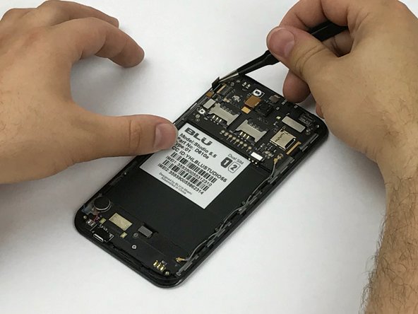

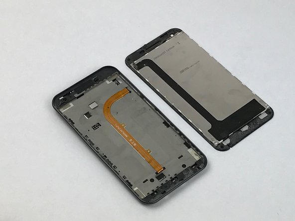

  6. Blu Studio 5.5 Touchscreen Display Replacement, Touchscreen Display: crwdns2935265:06crwdnd2935265:01crwdnd2935265:02crwdne2935265:0 Blu Studio 5.5 Touchscreen Display Replacement, Touchscreen Display: crwdns2935265:06crwdnd2935265:02crwdnd2935265:02crwdne2935265:0
    • Locate the flex cable connector that connects the screen to the motherboard.
    • Using tweezers, gently remove the flex cable connector from the motherboard.

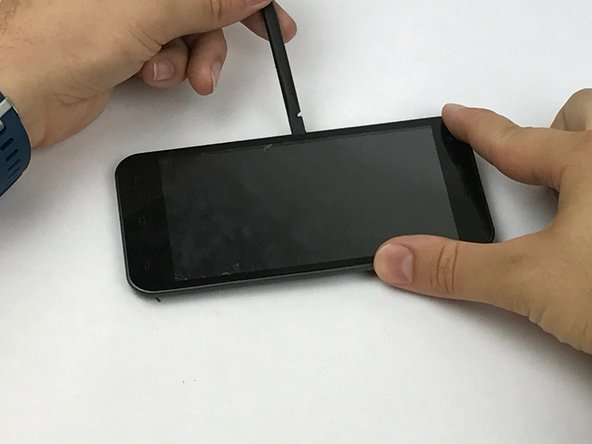

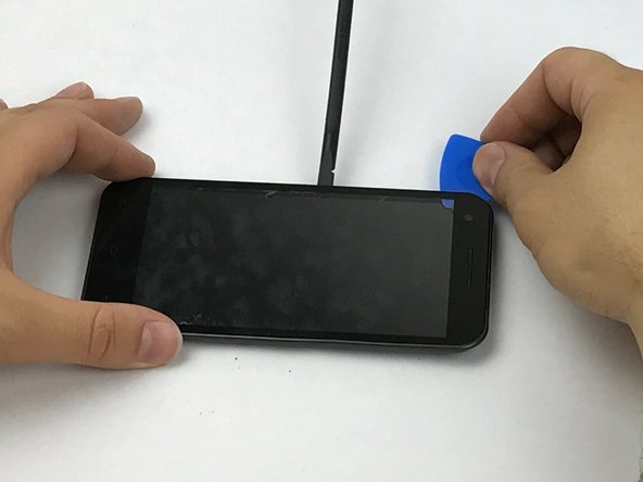

  7. Blu Studio 5.5 Touchscreen Display Replacement: crwdns2935265:07crwdnd2935265:01crwdnd2935265:03crwdne2935265:0 Blu Studio 5.5 Touchscreen Display Replacement: crwdns2935265:07crwdnd2935265:02crwdnd2935265:03crwdne2935265:0 Blu Studio 5.5 Touchscreen Display Replacement: crwdns2935265:07crwdnd2935265:03crwdnd2935265:03crwdne2935265:0
    • Using the spudger, begin to gently remove the adhesive around the screen.
    • Once all the border adhesive is removed, insert the pick between the screen and phone, Leave the spudger in to create space between the phone and screen to insert the pick.
    • If removing the adhesive is a challenge, you can use the iOpener by following the instructions to heat it up and placing it on the edges of the phone to loosen the adhesive.

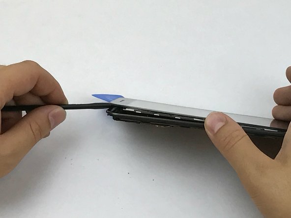

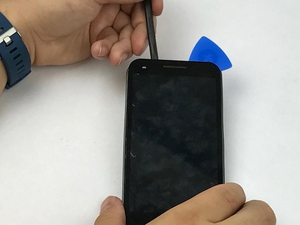

  8. Blu Studio 5.5 Touchscreen Display Replacement: crwdns2935265:08crwdnd2935265:01crwdnd2935265:03crwdne2935265:0 Blu Studio 5.5 Touchscreen Display Replacement: crwdns2935265:08crwdnd2935265:02crwdnd2935265:03crwdne2935265:0 Blu Studio 5.5 Touchscreen Display Replacement: crwdns2935265:08crwdnd2935265:03crwdnd2935265:03crwdne2935265:0
    • Once the pic is inserted, slide it under and around the screen to remove any adhesive that may have been left under the screen.
    • Once the majority of the adhesive is removed, gently lift the screen using the opening tool or the spudger.

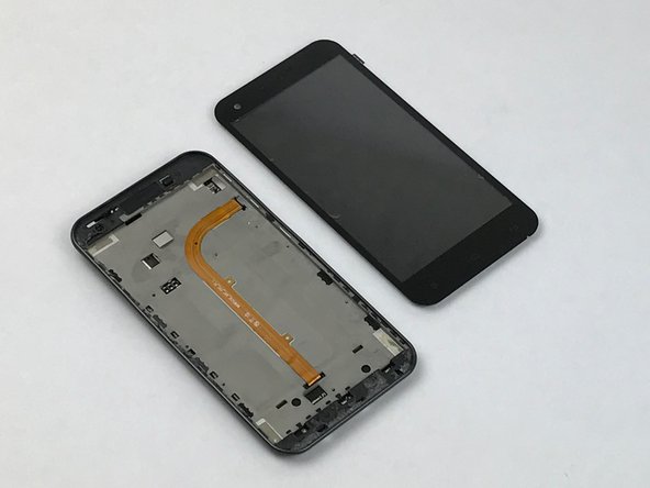

  9. Blu Studio 5.5 Touchscreen Display Replacement: crwdns2935265:09crwdnd2935265:01crwdnd2935265:03crwdne2935265:0 Blu Studio 5.5 Touchscreen Display Replacement: crwdns2935265:09crwdnd2935265:02crwdnd2935265:03crwdne2935265:0 Blu Studio 5.5 Touchscreen Display Replacement: crwdns2935265:09crwdnd2935265:03crwdnd2935265:03crwdne2935265:0
    • Once there is enough space between the phone and screen, feel free to use your hands to gently remove the screen completely.
