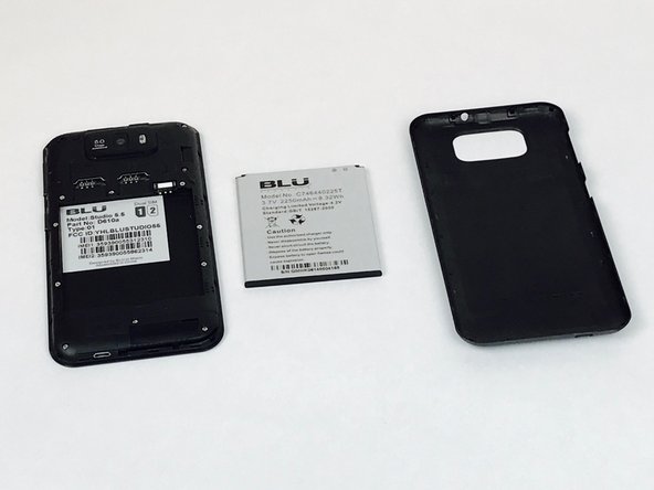

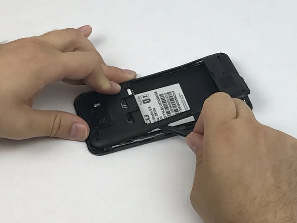

    • Locate the notch to remove the back panel at the lower left corner of the panel.
    • Insert the plastic opening tool or a fingernail into the notch.
    • Apply force upwards until back panel becomes loosened.
  2. Blu Studio 5.5 Sub PCBA Replacement: crwdns2935265:02crwdnd2935265:01crwdnd2935265:02crwdne2935265:0 Blu Studio 5.5 Sub PCBA Replacement: crwdns2935265:02crwdnd2935265:02crwdnd2935265:02crwdne2935265:0
    • Remove the loosened back panel and set aside.

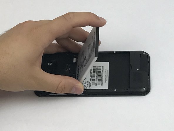

    • Locate the notch to remove the battery.
  3. Blu Studio 5.5 Sub PCBA Replacement: crwdns2935265:03crwdnd2935265:01crwdnd2935265:03crwdne2935265:0 Blu Studio 5.5 Sub PCBA Replacement: crwdns2935265:03crwdnd2935265:02crwdnd2935265:03crwdne2935265:0 Blu Studio 5.5 Sub PCBA Replacement: crwdns2935265:03crwdnd2935265:03crwdnd2935265:03crwdne2935265:0
    • Insert a plastic opening tool or your fingernail into the notch and apply force upwards until the battery is loosened.
    • Remove the battery and set aside.

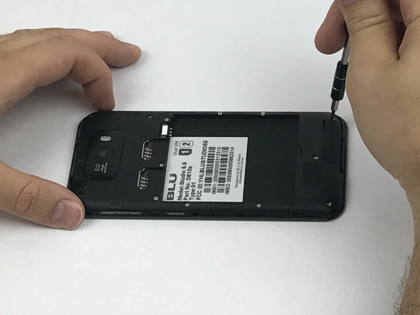

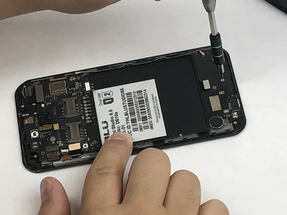

    • Locate all twelve screws along the back panel:
    • Seven 5mm screws.
    • Five 3.5mm screws.
    • Using a Phillips #000 screwdriver, remove all twelve screws.

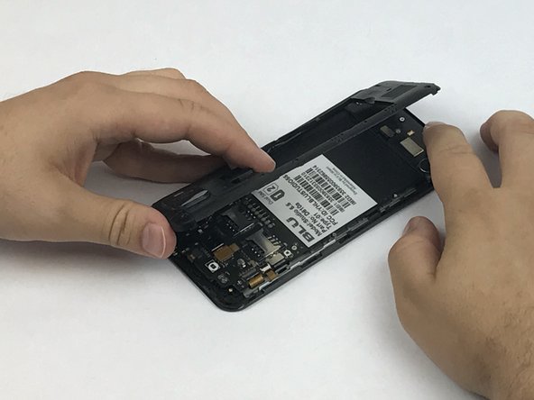

  5. Blu Studio 5.5 Sub PCBA Replacement: crwdns2935265:05crwdnd2935265:01crwdnd2935265:03crwdne2935265:0 Blu Studio 5.5 Sub PCBA Replacement: crwdns2935265:05crwdnd2935265:02crwdnd2935265:03crwdne2935265:0 Blu Studio 5.5 Sub PCBA Replacement: crwdns2935265:05crwdnd2935265:03crwdnd2935265:03crwdne2935265:0
    • Now that all the screws have been removed, use a plastic opening tool to carefully pry at each of the corners until loosened.
    • Be extra careful when prying open as it may damage or snap the thin sides of the panel.
    • Place the plastic opening tool inside the loosened panel and gently push upwards and move along the phone to remove the back panel.
    • Remove the panel as if you were turning the page of a book.

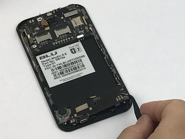

  6. Blu Studio 5.5 Sub PCBA Replacement, Sub PCBA: crwdns2935265:06crwdnd2935265:01crwdnd2935265:02crwdne2935265:0 Blu Studio 5.5 Sub PCBA Replacement, Sub PCBA: crwdns2935265:06crwdnd2935265:02crwdnd2935265:02crwdne2935265:0
    • Locate the screw holding down the sub PCBA.
    • Remove the screw using the Phillips #000 screwdriver.
  7. Blu Studio 5.5 Sub PCBA Replacement: crwdns2935265:07crwdnd2935265:01crwdnd2935265:03crwdne2935265:0 Blu Studio 5.5 Sub PCBA Replacement: crwdns2935265:07crwdnd2935265:02crwdnd2935265:03crwdne2935265:0 Blu Studio 5.5 Sub PCBA Replacement: crwdns2935265:07crwdnd2935265:03crwdnd2935265:03crwdne2935265:0

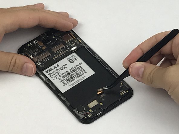

    • Locate the gold plated cable connecting the sub PCBA to the motherboard.
    • Locate the flex cable connector just above the sub PCBA screw.
    • Using tweezers, detach both cables from the sub PCBA.
  8. Blu Studio 5.5 Sub PCBA Replacement: crwdns2935265:08crwdnd2935265:01crwdnd2935265:02crwdne2935265:0 Blu Studio 5.5 Sub PCBA Replacement: crwdns2935265:08crwdnd2935265:02crwdnd2935265:02crwdne2935265:0

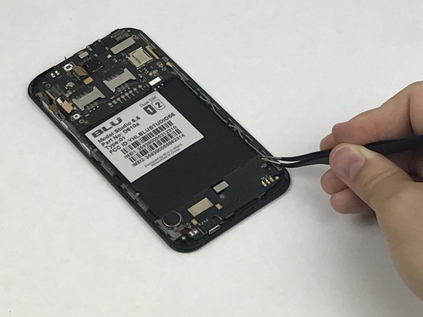

    • Note the red and blue wires connecting the sub PCBA to the speakers.
    • Either the speaker will need to be loosened and removed alongside the sub PCBA or the wires disconnected and resoldered during reassembly.
    • Using tweezers, grab the PCBA and remove gently from assembly.
