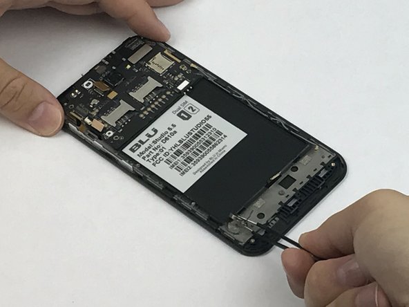

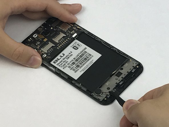

  6. Blu Studio 5.5 Speakers Replacement, Speakers: crwdns2935265:06crwdnd2935265:01crwdnd2935265:03crwdne2935265:0 Blu Studio 5.5 Speakers Replacement, Speakers: crwdns2935265:06crwdnd2935265:02crwdnd2935265:03crwdne2935265:0 Blu Studio 5.5 Speakers Replacement, Speakers: crwdns2935265:06crwdnd2935265:03crwdnd2935265:03crwdne2935265:0
    • Using a pair of tweezers grasp the speakers that are located below the battery and pry it off as it is glued onto the phone assembly.
    • The speakers are connected by a pair of red and blue wires that are soldered onto the SUB PCBA component and will need to be soldered back on.
    • You can now remove the speakers and replace them.
    • It might be better to consider replacing the entire SUB-PCBA board instead of just the speakers individually to avoid dealing with the re-connection of the two wires.
