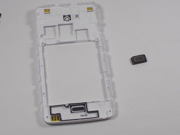

    • Use the Spudger to pop the inner back casing off. Do this by lightly raising the side of the battery housing, then sliding the Spudger around the case.
    • Pick up the inner back case and flip it over.
  7. Blu Studio 5.5 S Speaker Replacement, Speaker: crwdns2935265:07crwdnd2935265:01crwdnd2935265:03crwdne2935265:0 Blu Studio 5.5 S Speaker Replacement, Speaker: crwdns2935265:07crwdnd2935265:02crwdnd2935265:03crwdne2935265:0 Blu Studio 5.5 S Speaker Replacement, Speaker: crwdns2935265:07crwdnd2935265:03crwdnd2935265:03crwdne2935265:0

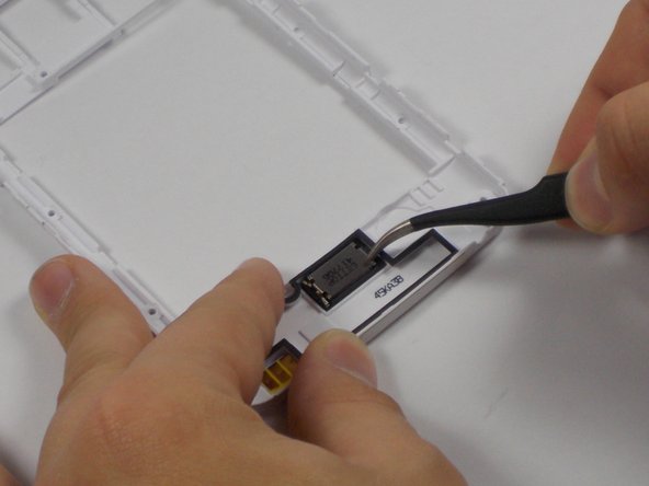

    • The speaker is located on the bottom of the back inner case. To remove it, use a pair of angled tweezers.
    • Use the tweezers to remove the speaker off of the casing.
    • Only put the tweezers in enough to gain leverage.
