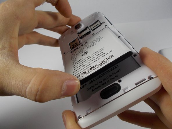

      • Once the back case is removed, locate the battery. It is the large brick embedded in the phone. It has BLU Products, a caution statement, and a barcode on it.
      • Insert your finger into the notch near the lower left of the battery, apply pressure and lift up.

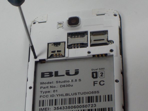

    1. Blu Studio 5.5 S Screen Replacement, Midframe: crwdns2935265:04crwdnd2935265:01crwdnd2935265:03crwdne2935265:0 Blu Studio 5.5 S Screen Replacement, Midframe: crwdns2935265:04crwdnd2935265:02crwdnd2935265:03crwdne2935265:0 Blu Studio 5.5 S Screen Replacement, Midframe: crwdns2935265:04crwdnd2935265:03crwdnd2935265:03crwdne2935265:0

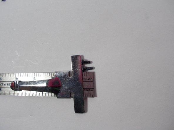

      • The speaker is located behind the inner back case. Using a Phillips #0 screwdriver, unscrew the 10, 7mm screws.
      • Using the Phillips #00 screwdriver, unscrew the two, 10mm screws at the bottom.

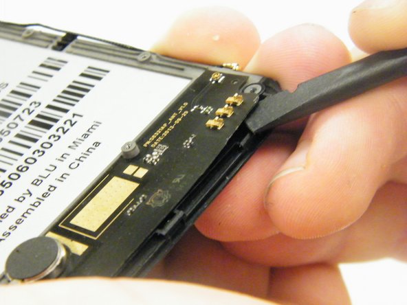

    2. Blu Studio 5.5 S Screen Replacement, Aesthetic Bottom Case: crwdns2935265:05crwdnd2935265:01crwdnd2935265:01crwdne2935265:0
      • Apply pressure and pop off the bottom aesthetic case, being careful not to break it.

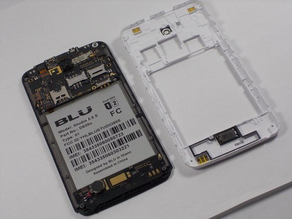

    3. Blu Studio 5.5 S Screen Replacement: crwdns2935265:06crwdnd2935265:01crwdnd2935265:03crwdne2935265:0 Blu Studio 5.5 S Screen Replacement: crwdns2935265:06crwdnd2935265:02crwdnd2935265:03crwdne2935265:0 Blu Studio 5.5 S Screen Replacement: crwdns2935265:06crwdnd2935265:03crwdnd2935265:03crwdne2935265:0

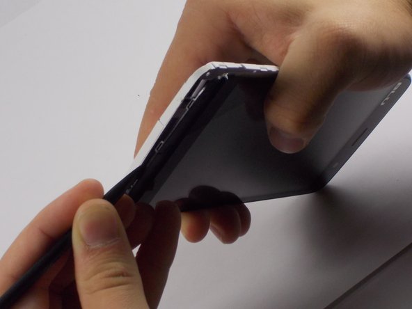

      • Use the Spudger to pop the inner back casing off. Do this by lightly raising the side of the battery housing, then sliding the Spudger around the case.
      • Pick up the inner back case and flip it over.

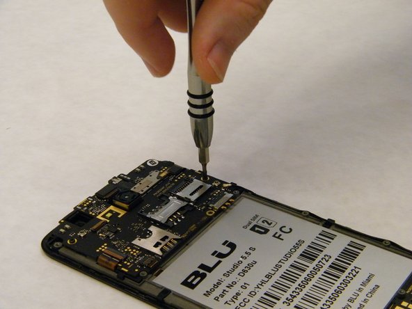

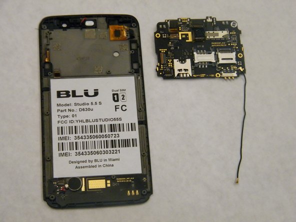

    1. Blu Studio 5.5 S Screen Replacement, Motherboard: crwdns2935265:07crwdnd2935265:01crwdnd2935265:03crwdne2935265:0 Blu Studio 5.5 S Screen Replacement, Motherboard: crwdns2935265:07crwdnd2935265:02crwdnd2935265:03crwdne2935265:0 Blu Studio 5.5 S Screen Replacement, Motherboard: crwdns2935265:07crwdnd2935265:03crwdnd2935265:03crwdne2935265:0
      • Remove the three 7 mm screws using the Phillips #00 Screwdiver.
      • Disconnect motherboard plug connector near bottom right of battery using fingers to pull off the cap plug.

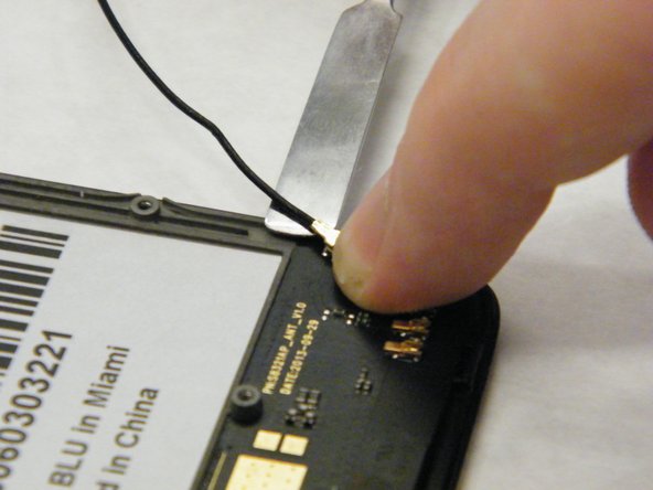

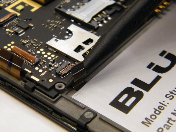

    2. Blu Studio 5.5 S Screen Replacement: crwdns2935265:08crwdnd2935265:01crwdnd2935265:03crwdne2935265:0 Blu Studio 5.5 S Screen Replacement: crwdns2935265:08crwdnd2935265:02crwdnd2935265:03crwdne2935265:0 Blu Studio 5.5 S Screen Replacement: crwdns2935265:08crwdnd2935265:03crwdnd2935265:03crwdne2935265:0
      • Use the nylon spudger to lift the release tabs by carefully grabbing the tabs from the sides and lifting up.
      • Release the four ribbon wires from the motherboard.

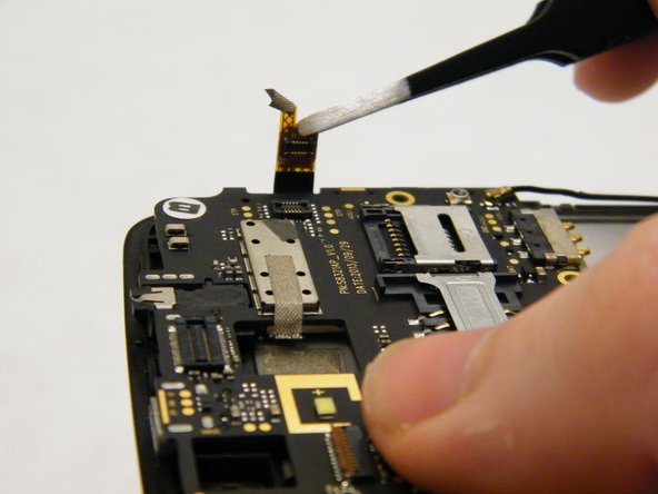

    3. Blu Studio 5.5 S Screen Replacement: crwdns2935265:09crwdnd2935265:01crwdnd2935265:02crwdne2935265:0 Blu Studio 5.5 S Screen Replacement: crwdns2935265:09crwdnd2935265:02crwdnd2935265:02crwdne2935265:0
      • Use the tweezers to grip the bottom of the motherboard and lift up.
