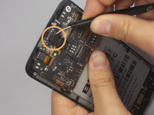

    • The rear camera is located in the center of the motherboard . It is connected by a ribbon wire / prong system.
    • Use tweezers to gently pop off the prong system, by pulling upwards on the black cap piece connected to the motherboard from the ribbon wire.

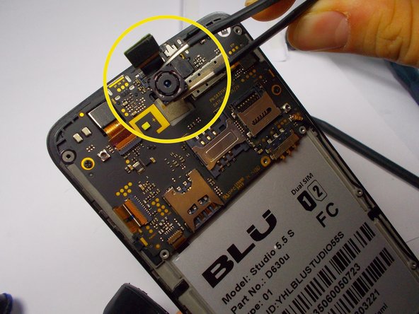

    • Use the Tweezers to pull the camera out of the housing.
    • When removing the back camera be careful not to scratch the lens, unless you are throwing it out.
