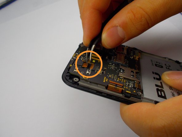

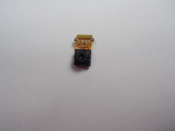

    • The frontward facing camera is located in the top left of the phone. It is connected to the motherboard by a ribbon connector, and a prong system.
    • Use a spudger to detach the front facing camera by flipping the orange tab on the top of the prong system.
    • Once the orange tab is up, pull out the orange ribbon wire.
  8. Blu Studio 5.5 S Front Facing Camera Replacement: crwdns2935265:08crwdnd2935265:01crwdnd2935265:02crwdne2935265:0 Blu Studio 5.5 S Front Facing Camera Replacement: crwdns2935265:08crwdnd2935265:02crwdnd2935265:02crwdne2935265:0
    • Use tweezers to pick up the ribbon wire, and lift. The frontward facing camera will follow suit.
