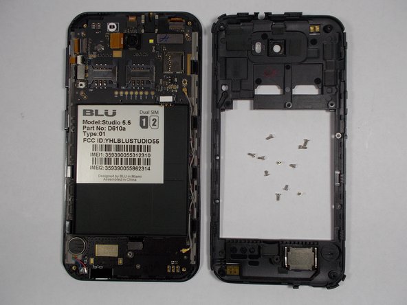

    • Begin by removing the 12 screws along the back of the device.
    • 1 of these screws will be underneath a white sticker. Just press the screwdriver through it and remove it normally.
    • 5 of these screws are 3.5mm, while the remaining 7 are 5mm.
  4. Blu Studio 5.5 Micro USB Port Replacement: crwdns2935265:04crwdnd2935265:01crwdnd2935265:02crwdne2935265:0 Blu Studio 5.5 Micro USB Port Replacement: crwdns2935265:04crwdnd2935265:02crwdnd2935265:02crwdne2935265:0
    • Using your plastic opening tool, begin carefully prying the plastic shell from the phone.
    • Make your way around the edge slowly and lift the shell off when you have made a full circuit.
