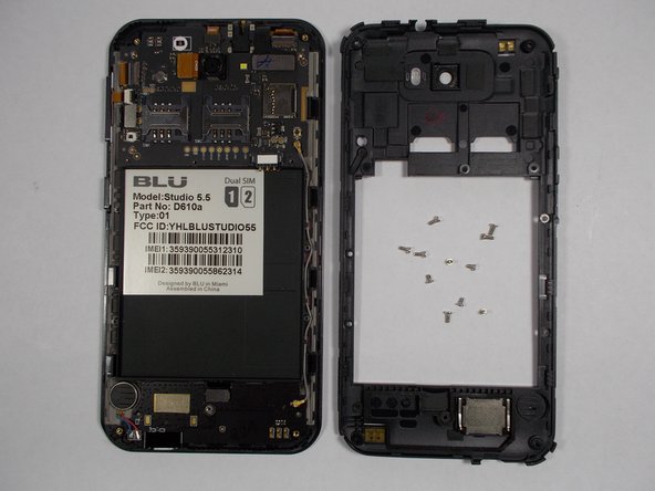

  3. Blu Studio 5.5 Camera Replacement, Camera: crwdns2935265:03crwdnd2935265:01crwdnd2935265:01crwdne2935265:0
    • Begin by removing the 12 3.5mm screws along the back of the device.
    • 1 of these screws will be underneath a white sticker. Just press the screwdriver through it and remove it normally.
  4. Blu Studio 5.5 Camera Replacement: crwdns2935265:04crwdnd2935265:01crwdnd2935265:02crwdne2935265:0 Blu Studio 5.5 Camera Replacement: crwdns2935265:04crwdnd2935265:02crwdnd2935265:02crwdne2935265:0
    • Using your plastic opening tool, begin carefully prying the plastic shell from the phone.
    • Make your way around the edge slowly and lift the shell off when you have made a full circuit.

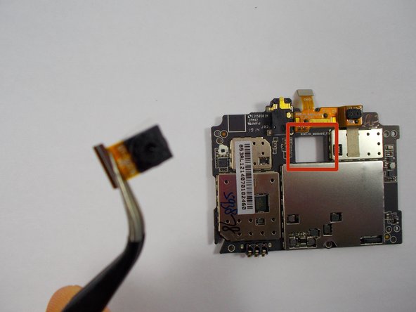

  8. Blu Studio 5.5 Camera Replacement: crwdns2935265:08crwdnd2935265:01crwdnd2935265:01crwdne2935265:0
    • Carefully wedge the plastic remover tool underneath the corner of the camera module and slowly pry until it comes free.

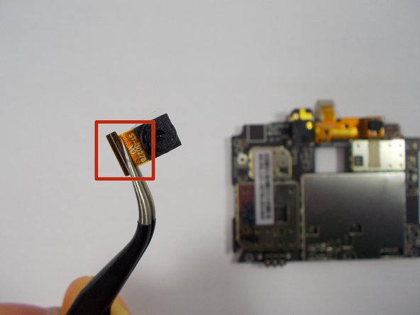

  9. Blu Studio 5.5 Camera Replacement: crwdns2935265:09crwdnd2935265:01crwdnd2935265:03crwdne2935265:0 Blu Studio 5.5 Camera Replacement: crwdns2935265:09crwdnd2935265:02crwdnd2935265:03crwdne2935265:0 Blu Studio 5.5 Camera Replacement: crwdns2935265:09crwdnd2935265:03crwdnd2935265:03crwdne2935265:0
    • Use tweezers to lift the camera module out, taking care not to get any fingerprints on it.
    • During reassembly, make sure the ribbon attached to the camera goes up and through the square hole on the motherboard so it is able to reconnect properly.
