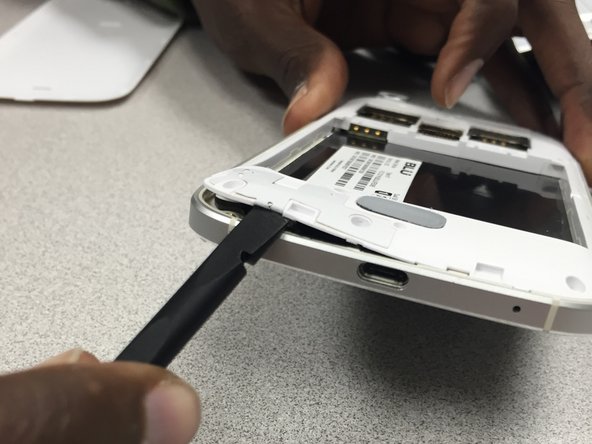

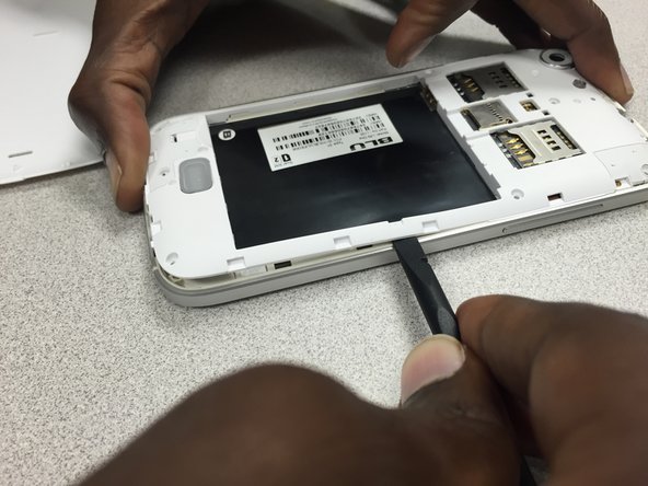

  3. Blu L120 Motherboard Replacement, Rear Panel  removal: crwdns2935265:03crwdnd2935265:01crwdnd2935265:03crwdne2935265:0 Blu L120 Motherboard Replacement, Rear Panel  removal: crwdns2935265:03crwdnd2935265:02crwdnd2935265:03crwdne2935265:0 Blu L120 Motherboard Replacement, Rear Panel  removal: crwdns2935265:03crwdnd2935265:03crwdnd2935265:03crwdne2935265:0
    • Use the pry tool to gently separate the panel from the frame, starting from the bottom left corner and continue along the edge of the phone.
    • *WARNING* by doing this, you will void the manufacturers warranty.

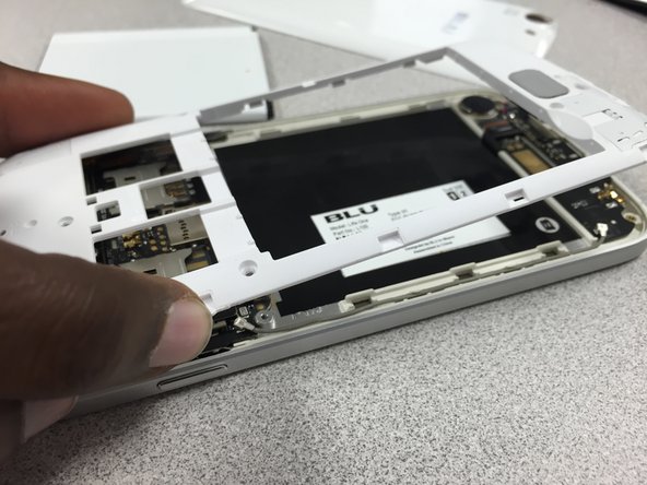

  4. Blu L120 Motherboard Replacement, Separate back panel from frame: crwdns2935265:04crwdnd2935265:01crwdnd2935265:03crwdne2935265:0 Blu L120 Motherboard Replacement, Separate back panel from frame: crwdns2935265:04crwdnd2935265:02crwdnd2935265:03crwdne2935265:0 Blu L120 Motherboard Replacement, Separate back panel from frame: crwdns2935265:04crwdnd2935265:03crwdnd2935265:03crwdne2935265:0
    • Continue using the pry tool around the back panel of the phone to separate both pieces.
    • Once you have gone around the entire frame, use both hands to pull it apart.

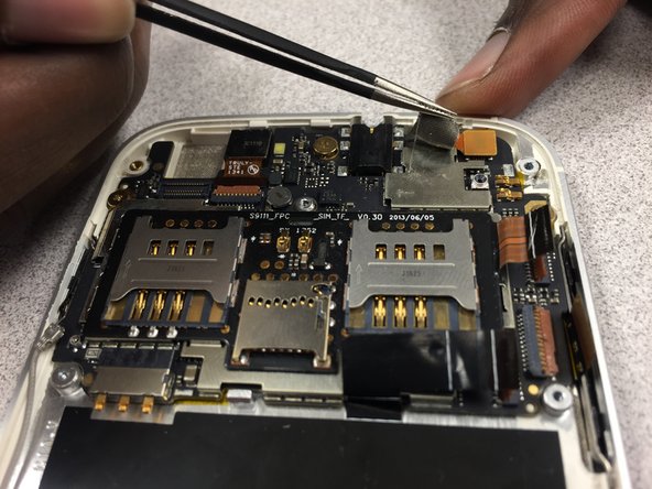

  5. Blu L120 Motherboard Replacement, Camera Removal: crwdns2935265:05crwdnd2935265:01crwdnd2935265:03crwdne2935265:0 Blu L120 Motherboard Replacement, Camera Removal: crwdns2935265:05crwdnd2935265:02crwdnd2935265:03crwdne2935265:0 Blu L120 Motherboard Replacement, Camera Removal: crwdns2935265:05crwdnd2935265:03crwdnd2935265:03crwdne2935265:0
    • Use the pry tool to disconnect the camera from the device.
    • Gently lift the camera up and use the tweezers to remove it from the phone.
    • Reinstall the camera. Then follow the guide in reverse to put the phone back together.

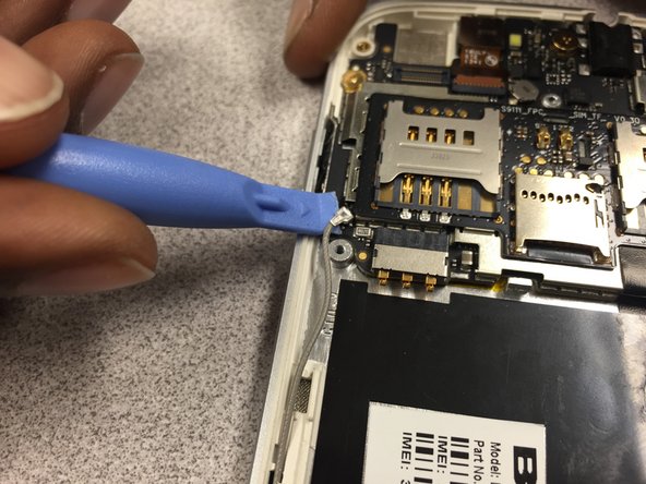

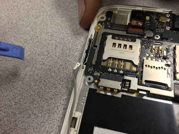

  6. Blu L120 Motherboard Replacement, Motherboard: crwdns2935265:06crwdnd2935265:01crwdnd2935265:03crwdne2935265:0 Blu L120 Motherboard Replacement, Motherboard: crwdns2935265:06crwdnd2935265:02crwdnd2935265:03crwdne2935265:0 Blu L120 Motherboard Replacement, Motherboard: crwdns2935265:06crwdnd2935265:03crwdnd2935265:03crwdne2935265:0
    • Remove these three screws using 00 Philips screwdriver. Note the smaller screw circled in orange.
    • Then gently pry up on the metal antenna connector at the end of the grey wire. Move the wire out of the way.

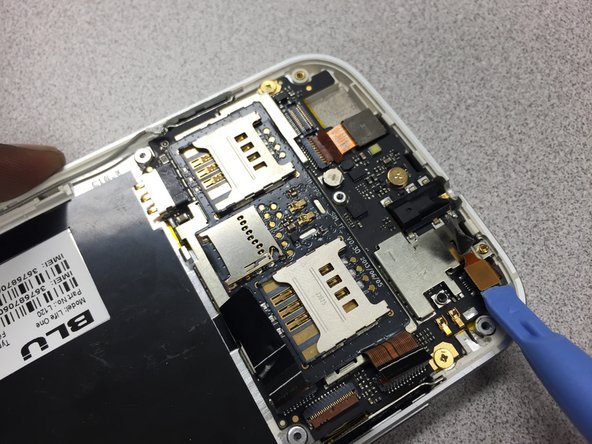

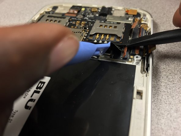

  7. Blu L120 Motherboard Replacement: crwdns2935265:07crwdnd2935265:01crwdnd2935265:02crwdne2935265:0 Blu L120 Motherboard Replacement: crwdns2935265:07crwdnd2935265:02crwdnd2935265:02crwdne2935265:0
    • Next you must disconnect these three cables.
    • Use your pry tool to lift up on the brown tab to release the ribbon cable.

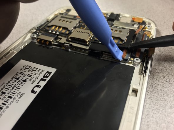

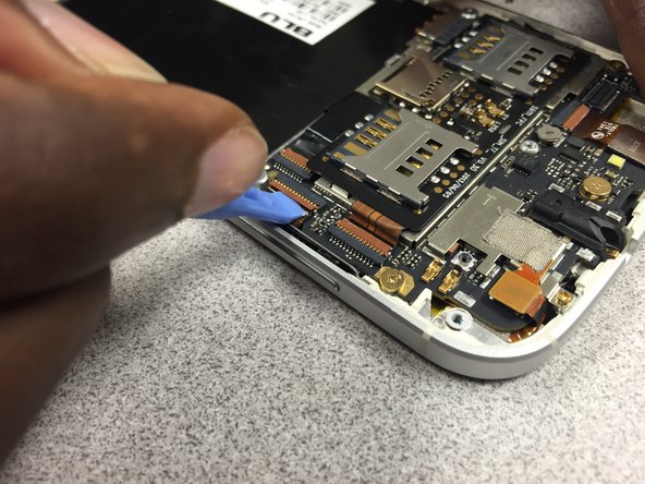

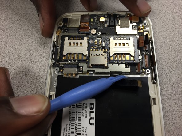

  8. Blu L120 Motherboard Replacement: crwdns2935265:08crwdnd2935265:01crwdnd2935265:03crwdne2935265:0 Blu L120 Motherboard Replacement: crwdns2935265:08crwdnd2935265:02crwdnd2935265:03crwdne2935265:0 Blu L120 Motherboard Replacement: crwdns2935265:08crwdnd2935265:03crwdnd2935265:03crwdne2935265:0
    • For the last ribbon cable, use a spudger to gently pry up on the board under the right sim card slot.
    • Next, take your pry tool to lift up on the brown tab holding down the ribbon cable.
    • The cable is now free to be pulled back out of its' slot.

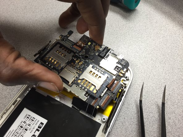

  10. Blu L120 Motherboard Replacement: crwdns2935265:010crwdnd2935265:01crwdnd2935265:03crwdne2935265:0 Blu L120 Motherboard Replacement: crwdns2935265:010crwdnd2935265:02crwdnd2935265:03crwdne2935265:0 Blu L120 Motherboard Replacement: crwdns2935265:010crwdnd2935265:03crwdnd2935265:03crwdne2935265:0
    • Now that the motherboard is free to be pried up, be sure that no cables are in the way or can be snagged when removing the motherboard.
    • Just lift up and away.
    • Follow the instructions in reverse to put the phone back together.
