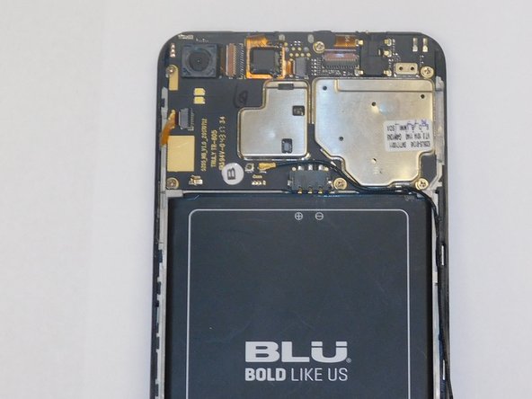

      • Before beginning the guide, be sure that this replacement guide addresses your specific problem.
      • Locate the two Torx screws at the bottom of the phone and remove them.

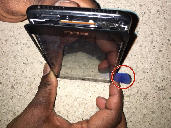

    2. Blu Grand M2 Display Replacement: crwdns2935265:02crwdnd2935265:01crwdnd2935265:01crwdne2935265:0
      • Use the pry tool to wedge between the phone's frame and the back plate.
      • Carefully remove the back plate using the suction tool.
      • Be careful not to damage the phone display and/or the inside components while using the pry tool and the suction tool.

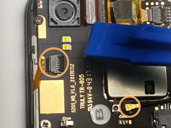

      • Once the back panel is removed, locate the connector of the display shown in figure 1 on the motherboard side.
      • There will be an orange sticker above the previously mentioned connector. You can gently lift the connector up to release it.
      • Disconnect the two remaining connectors shown in figure 3.

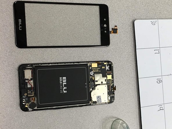

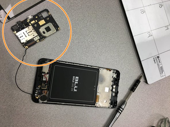

      • After removing the connectors, locate the six Phillips screws on the motherboard side and remove them.
      • After removing the six Phillips screws, remove the motherboard piece.
