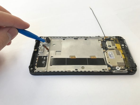

  10. Blu Grand M Vibrator Replacement, Vibrator: crwdns2935265:010crwdnd2935265:01crwdnd2935265:02crwdne2935265:0 Blu Grand M Vibrator Replacement, Vibrator: crwdns2935265:010crwdnd2935265:02crwdnd2935265:02crwdne2935265:0
    • To remove the vibrator, use the plastic opening tool to pry it out.
