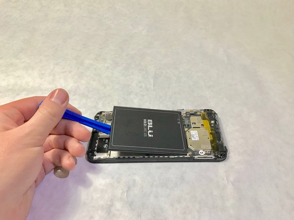

  4. Blu Grand M Microphone Replacement: crwdns2935265:04crwdnd2935265:01crwdnd2935265:02crwdne2935265:0 Blu Grand M Microphone Replacement: crwdns2935265:04crwdnd2935265:02crwdnd2935265:02crwdne2935265:0
    • There is a patch of adhesive underneath the battery, which can make it difficult to remove.
    • Place the plastic opening tool in the highlighted indent, and push up on the battery to remove it.

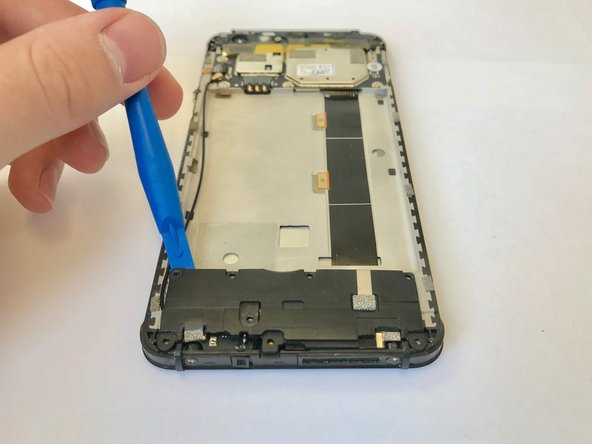

  5. Blu Grand M Microphone Replacement, Speaker: crwdns2935265:05crwdnd2935265:01crwdnd2935265:02crwdne2935265:0 Blu Grand M Microphone Replacement, Speaker: crwdns2935265:05crwdnd2935265:02crwdnd2935265:02crwdne2935265:0
    • Remove the exterior cover with a Torx 2 screwdriver, to remove two 3.0mm screws.
    • Remove the 4.0mm screw with a Phillips #000 screwdriver.
    • Using the blue plastic opening tool, remove the exterior cover.

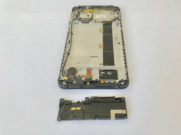

  6. Blu Grand M Microphone Replacement: crwdns2935265:06crwdnd2935265:01crwdnd2935265:03crwdne2935265:0 Blu Grand M Microphone Replacement: crwdns2935265:06crwdnd2935265:02crwdnd2935265:03crwdne2935265:0 Blu Grand M Microphone Replacement: crwdns2935265:06crwdnd2935265:03crwdnd2935265:03crwdne2935265:0
    • Use a Phillips #000 screwdriver to remove each of the four 1.5mm screws.
    • Use a Phillips #000 screwdriver to remove each of the three 3.0mm screws.
    • Use the plastic opening tool to remove the speaker.

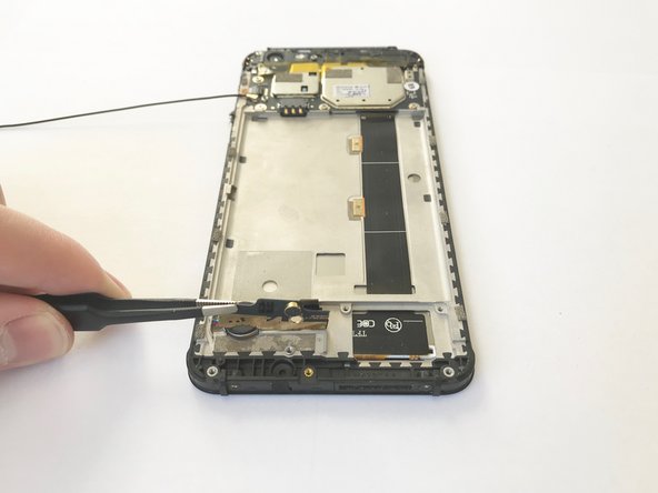

  7. Blu Grand M Microphone Replacement, Microphone: crwdns2935265:07crwdnd2935265:01crwdnd2935265:02crwdne2935265:0 Blu Grand M Microphone Replacement, Microphone: crwdns2935265:07crwdnd2935265:02crwdnd2935265:02crwdne2935265:0
    • Disconnect the black wire with a pair of tweezers.
    • The black wire can swivel out of the way to easily access the next microphone.

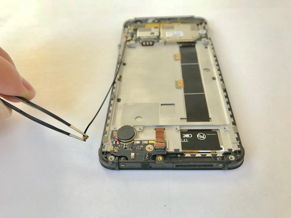

  8. Blu Grand M Microphone Replacement: crwdns2935265:08crwdnd2935265:01crwdnd2935265:02crwdne2935265:0 Blu Grand M Microphone Replacement: crwdns2935265:08crwdnd2935265:02crwdnd2935265:02crwdne2935265:0
    • Use a pair of tweezers to remove the orange data cable as shown.

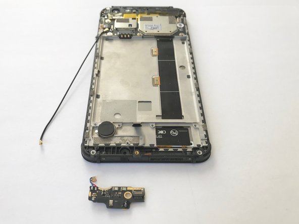

  9. Blu Grand M Microphone Replacement: crwdns2935265:09crwdnd2935265:01crwdnd2935265:03crwdne2935265:0 Blu Grand M Microphone Replacement: crwdns2935265:09crwdnd2935265:02crwdnd2935265:03crwdne2935265:0 Blu Grand M Microphone Replacement: crwdns2935265:09crwdnd2935265:03crwdnd2935265:03crwdne2935265:0
    • There will be glue holding the wires down, and they can be glued back in place after.
    • Use the plastic opening tool to lift the microphone out of place.
    • Use a pair of tweezers to lift the microphone out of the phone.
