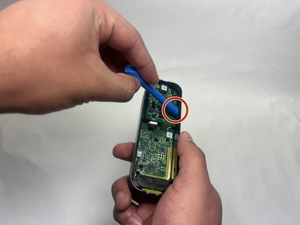

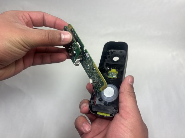

  5. Blink Video Doorbell LED Light Replacement, LED Light: crwdns2935265:05crwdnd2935265:01crwdnd2935265:03crwdne2935265:0 Blink Video Doorbell LED Light Replacement, LED Light: crwdns2935265:05crwdnd2935265:02crwdnd2935265:03crwdne2935265:0 Blink Video Doorbell LED Light Replacement, LED Light: crwdns2935265:05crwdnd2935265:03crwdnd2935265:03crwdne2935265:0
    • Remove the three 6 mm screws from the upper part of the motherboard using a JIS #1 screwdriver.
    • Use an opening tool to release the motherboard from the device.
  6. Blink Video Doorbell LED Light Replacement: crwdns2935265:06crwdnd2935265:01crwdnd2935265:03crwdne2935265:0 Blink Video Doorbell LED Light Replacement: crwdns2935265:06crwdnd2935265:02crwdnd2935265:03crwdne2935265:0 Blink Video Doorbell LED Light Replacement: crwdns2935265:06crwdnd2935265:03crwdnd2935265:03crwdne2935265:0
    • Use a soldering iron to desolder the LED connections from the motherboard.
