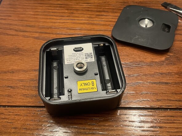

    • Set the camera on a working surface with the lens facing down.
  2. Blink Camera Outdoor 3 Batteries Replacement: crwdns2935265:02crwdnd2935265:01crwdnd2935265:01crwdne2935265:0
    • Use a flathead screwdriver to loosen the screw that secures the back cover.
  3. Blink Camera Outdoor 3 Batteries Replacement: crwdns2935265:03crwdnd2935265:01crwdnd2935265:02crwdne2935265:0 Blink Camera Outdoor 3 Batteries Replacement: crwdns2935265:03crwdnd2935265:02crwdnd2935265:02crwdne2935265:0
    • Lift the rear case up and off.
  4. Blink Camera Outdoor 3 Batteries Replacement: crwdns2935265:04crwdnd2935265:01crwdnd2935265:02crwdne2935265:0 Blink Camera Outdoor 3 Batteries Replacement: crwdns2935265:04crwdnd2935265:02crwdnd2935265:02crwdne2935265:0
    • Lift the + side up to remove the old batteries.

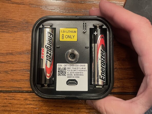

  5. Blink Camera Outdoor 3 Batteries Replacement: crwdns2935265:05crwdnd2935265:01crwdnd2935265:01crwdne2935265:0
    • Insert new AA batteries in the correct orientation.
This guide is essential because Blink Security Cameras provide security and peace of mind. If the batteries die, the camera stops functioning, leaving the property unmonitored. By providing an easy-to-follow guide with pictures for each step, helping users ensure their cameras stay functional and provide uninterrupted security.
