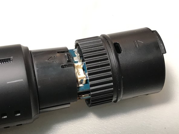

    • Near the opposite end of the dashcam from where you removed the plastic window, you'll see a small opening on the side of the end-cap.
    • Using a small flat bladed screwdriver, press on the plastic tab that you find inside that opening.
    • Pressing on that tab should release the plastic end-cap so that you can slide it off the end of the dashcam's cylindrical body.
    • The 3rd photo shows the end-cap after it's been removed.

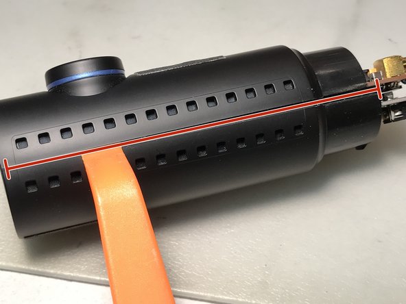

  4. Blackvue DR650GW-2CH Dashcam RTC Battery Replacement, Separating the body: crwdns2935265:04crwdnd2935265:01crwdnd2935265:03crwdne2935265:0 Blackvue DR650GW-2CH Dashcam RTC Battery Replacement, Separating the body: crwdns2935265:04crwdnd2935265:02crwdnd2935265:03crwdne2935265:0 Blackvue DR650GW-2CH Dashcam RTC Battery Replacement, Separating the body: crwdns2935265:04crwdnd2935265:03crwdnd2935265:03crwdne2935265:0
    • Next step is to separate the two halves of the cylindrical dashcam body. I used an old credit card as well as a spudger tool for this step.
    • Starting from the right end, work your way carefully along the horizontal crack between the two halves using a spudger and/or credit card. Be patient, don't use too much force or you may break one or more of the internal plastic tabs.
    • Once you've loosened the tabs holding one side of the body, turn the dashcam over and loosen the other side.
    • In the 3rd photo, you can see the location of 2 of the internal tabs holding the body together, in the small opening betwen halves. There are 4 of these internal tabs on each side.
