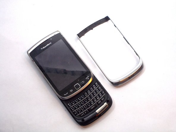

    • Remove front silver trim by using plastic opening tools and wiggle it off.
    • This is difficult to remove, but it should come off if you do it with caution.

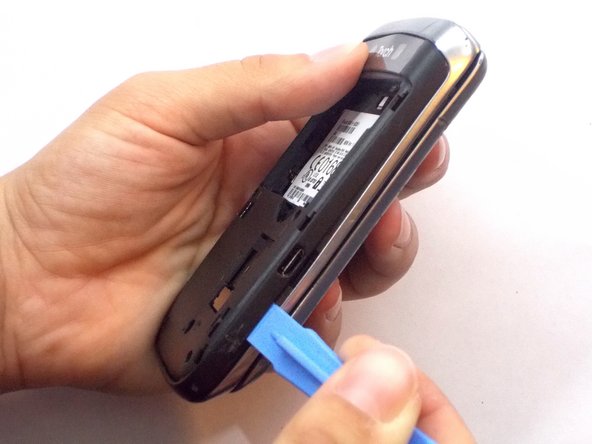

    • Use the plastic removal tool to remove the entire back cover.

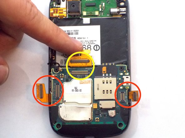

    • Peel off the three ribbon cables
    • They are orange and located on each side as well as on the top of the logic board
    • The cable circled in yellow is glued to the silver cap. Pull the ribbon cable upward towards the battery area.

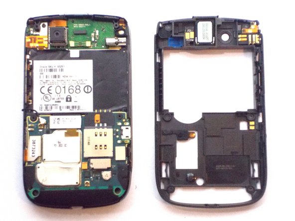

  9. Blackberry Torch 9810 Screen Replacement, Logic Board: crwdns2935265:09crwdnd2935265:01crwdnd2935265:01crwdne2935265:0
    • Take out your logic board

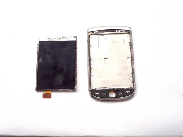

  11. Blackberry Torch 9810 Screen Replacement, Remove the Screen: crwdns2935265:011crwdnd2935265:01crwdnd2935265:01crwdne2935265:0
    • Separate the screen from its frame
    • After this step, you will need a torx bit smaller than a T-4. The circled display assembly can be replaced as a unit if you wish. In that case, this is the final step.

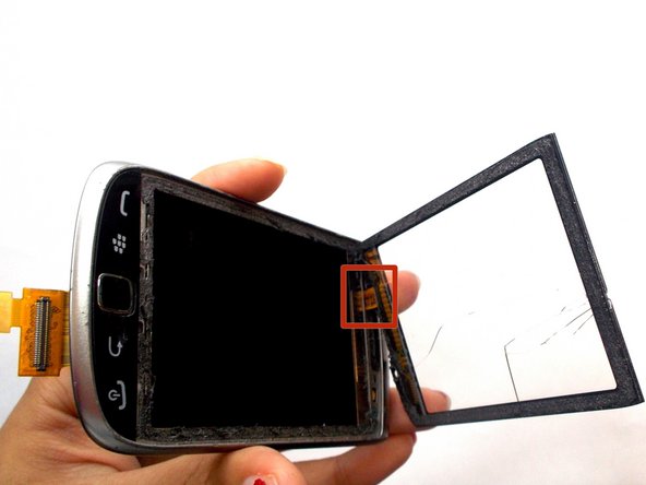

  13. Blackberry Torch 9810 Screen Replacement, Remove the Digizer: crwdns2935265:013crwdnd2935265:01crwdnd2935265:02crwdne2935265:0 Blackberry Torch 9810 Screen Replacement, Remove the Digizer: crwdns2935265:013crwdnd2935265:02crwdnd2935265:02crwdne2935265:0
    • Remove gold sticky film that attaches the digitizer to the screen
    • Separate the digitizer from its screen
    • Be careful not to tear the ribbon cable on the left side of the digitizer. That will be removed in a later step.
