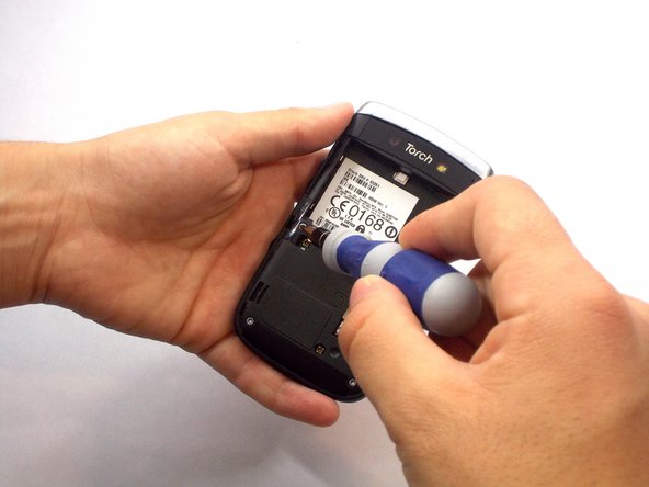

  3. Blackberry Torch 9810 Rear Facing Camera Replacement, Unscrew Screws: crwdns2935265:03crwdnd2935265:01crwdnd2935265:02crwdne2935265:0 Blackberry Torch 9810 Rear Facing Camera Replacement, Unscrew Screws: crwdns2935265:03crwdnd2935265:02crwdnd2935265:02crwdne2935265:0
    • Unscrew the four screws using the T6 screw driver
    • If you remove the screw in red, you void the warranty!

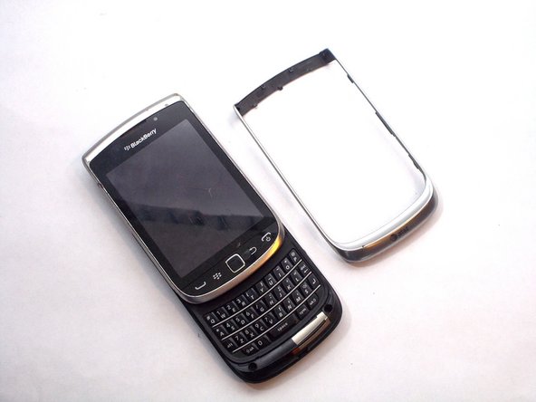

  4. Blackberry Torch 9810 Rear Facing Camera Replacement, Wiggle Wiggle: crwdns2935265:04crwdnd2935265:01crwdnd2935265:02crwdne2935265:0 Blackberry Torch 9810 Rear Facing Camera Replacement, Wiggle Wiggle: crwdns2935265:04crwdnd2935265:02crwdnd2935265:02crwdne2935265:0
    • Remove front silver trim by using plastic opening tools and wiggle it off.
    • (This is a little difficult to remove) Pull the bottom upward and pull the top downward.

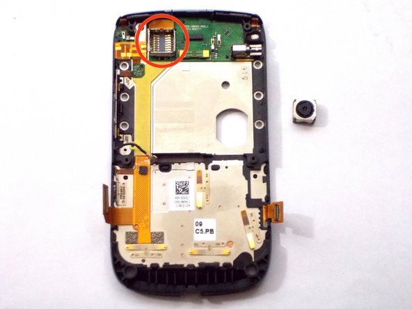

  5. Blackberry Torch 9810 Rear Facing Camera Replacement, Smaller Screws That Must Go: crwdns2935265:05crwdnd2935265:01crwdnd2935265:01crwdne2935265:0
    • Once you remove the rim cover, you should find two more screws on the top. Unscrew them using the T6 screw driver.
  6. Blackberry Torch 9810 Rear Facing Camera Replacement, Camera Sensor: crwdns2935265:06crwdnd2935265:01crwdnd2935265:02crwdne2935265:0 Blackberry Torch 9810 Rear Facing Camera Replacement, Camera Sensor: crwdns2935265:06crwdnd2935265:02crwdnd2935265:02crwdne2935265:0
    • Use the Phillip screw driver to wiggle the camera sensor out.
    • Carefully remove this
