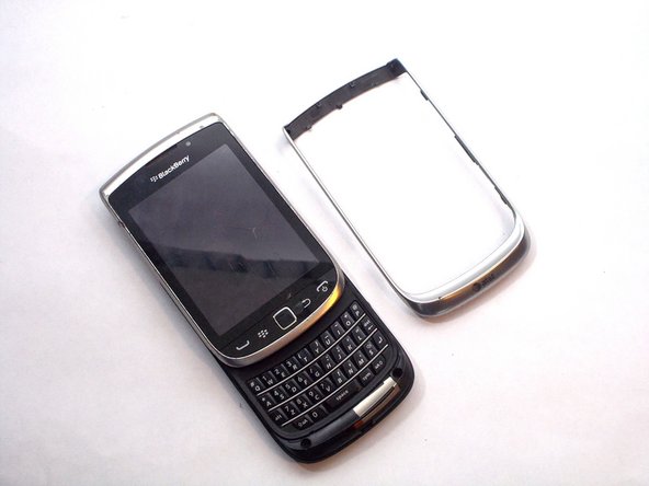

  4. Blackberry Torch 9810 Cursor Key Replacement, Wiggle Wiggle: crwdns2935265:04crwdnd2935265:01crwdnd2935265:02crwdne2935265:0 Blackberry Torch 9810 Cursor Key Replacement, Wiggle Wiggle: crwdns2935265:04crwdnd2935265:02crwdnd2935265:02crwdne2935265:0
    • Slide the screen up.
    • Remove front silver trim by using a plastic opening tools and wiggle it off.
    • This is difficult to remove, but it should come off if you do it with caution.

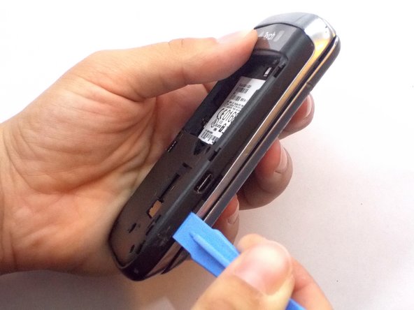

  6. Blackberry Torch 9810 Cursor Key Replacement, Remove the Back: crwdns2935265:06crwdnd2935265:01crwdnd2935265:03crwdne2935265:0 Blackberry Torch 9810 Cursor Key Replacement, Remove the Back: crwdns2935265:06crwdnd2935265:02crwdnd2935265:03crwdne2935265:0 Blackberry Torch 9810 Cursor Key Replacement, Remove the Back: crwdns2935265:06crwdnd2935265:03crwdnd2935265:03crwdne2935265:0
    • Use the plastic opening tools to remove the entire back off the phone.

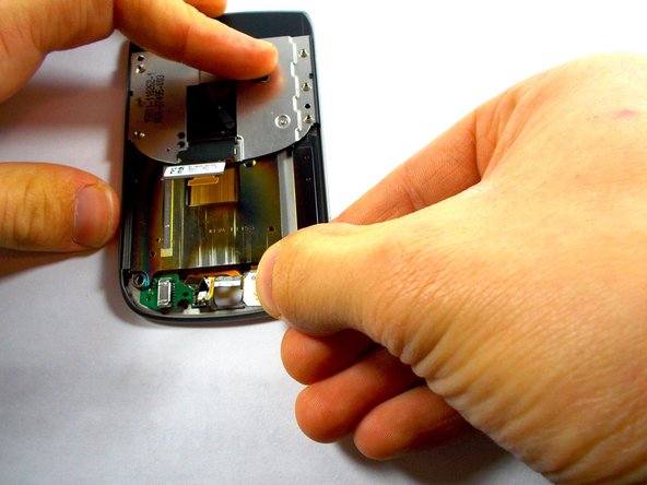

  13. Blackberry Torch 9810 Cursor Key Replacement, Carefully Remove a Ribbion: crwdns2935265:013crwdnd2935265:01crwdnd2935265:01crwdne2935265:0
    • There is one last orange ribbon cable that needs to be pulled and behind it is the cursor

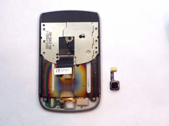

  14. Blackberry Torch 9810 Cursor Key Replacement, Cursor Key: crwdns2935265:014crwdnd2935265:01crwdnd2935265:03crwdne2935265:0 Blackberry Torch 9810 Cursor Key Replacement, Cursor Key: crwdns2935265:014crwdnd2935265:02crwdnd2935265:03crwdne2935265:0 Blackberry Torch 9810 Cursor Key Replacement, Cursor Key: crwdns2935265:014crwdnd2935265:03crwdnd2935265:03crwdne2935265:0
    • Push the cursor upwards and out of the socket.
    • Gently pull out the white box by pulling straight out of the socket to the right. This is your cursor
