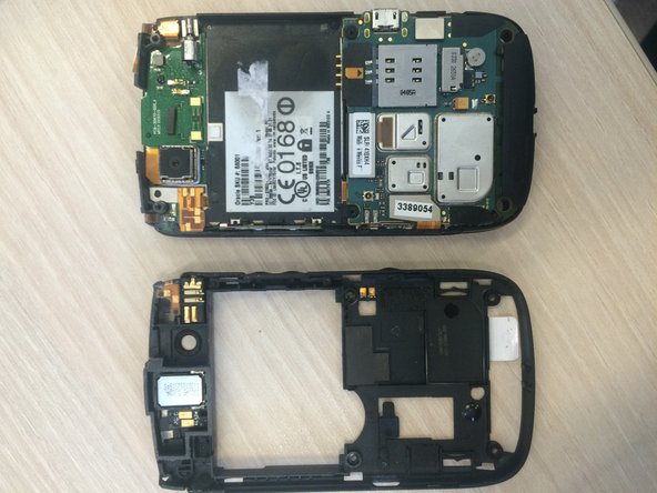

  3. Blackberry Torch 9800 Replacing rear camera: crwdns2935265:03crwdnd2935265:01crwdnd2935265:03crwdne2935265:0 Blackberry Torch 9800 Replacing rear camera: crwdns2935265:03crwdnd2935265:02crwdnd2935265:03crwdne2935265:0 Blackberry Torch 9800 Replacing rear camera: crwdns2935265:03crwdnd2935265:03crwdnd2935265:03crwdne2935265:0
    • Two new screws have been exposed near the top of the back.
    • Remove the two screws using the T7 screwdriver.
    • Remove the back panel using the plastic opening tool.

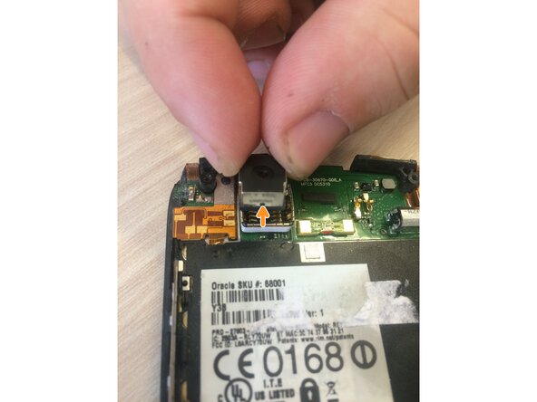

  4. Blackberry Torch 9800 Replacing rear camera: crwdns2935265:04crwdnd2935265:01crwdnd2935265:02crwdne2935265:0 Blackberry Torch 9800 Replacing rear camera: crwdns2935265:04crwdnd2935265:02crwdnd2935265:02crwdne2935265:0
    • Carefully use flathead screwdriver to free camera sensor.
    • Wiggle on the right and left sides, not the top and bottom sides.
  5. Blackberry Torch 9800 Replacing rear camera: crwdns2935265:05crwdnd2935265:01crwdnd2935265:01crwdne2935265:0
    • To install the new camera sensor, place in slot. Reassemble phone by doing steps 1-3 in reverse order.
