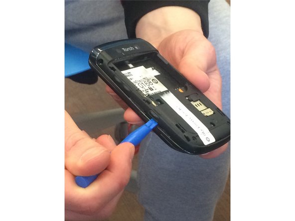

    • Remove the side trim using the plastic opening tool.
    • Apply pressure to push the top side of the side trim towards the phone while pulling the bottom away from the phone to remove the side trim.
    • The side trim is fragile and easily fractured, so handful it with care.

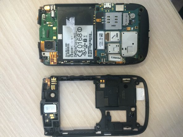

  3. Blackberry Torch 9800 Logic Board Replacement: crwdns2935265:03crwdnd2935265:01crwdnd2935265:03crwdne2935265:0 Blackberry Torch 9800 Logic Board Replacement: crwdns2935265:03crwdnd2935265:02crwdnd2935265:03crwdne2935265:0 Blackberry Torch 9800 Logic Board Replacement: crwdns2935265:03crwdnd2935265:03crwdnd2935265:03crwdne2935265:0
    • Remove the two screws that have been revealed at the top of the device using the T6 screwdriver.
    • You should now be able to easily lift the back panel from the phone.

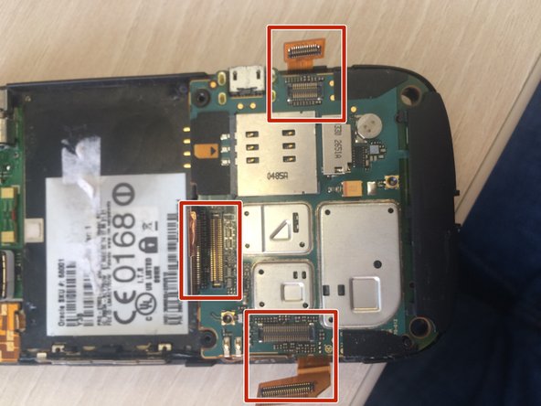

    • Using your hands, carefully peel the three ribbon cable caps from the logic board.

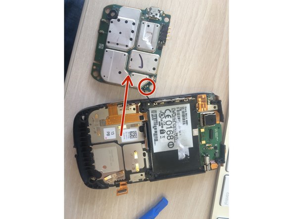

  5. Blackberry Torch 9800 Logic Board Replacement: crwdns2935265:05crwdnd2935265:01crwdnd2935265:02crwdne2935265:0 Blackberry Torch 9800 Logic Board Replacement: crwdns2935265:05crwdnd2935265:02crwdnd2935265:02crwdne2935265:0
    • Lift logic board slightly. The logic board will remain attached to the phone by a small antenna wire.
    • Using your hands, carefully lift the clasp attached to the antenna wire straight upward away from the logic board.
    • Make sure not to disconnect the antenna wire from its clasp.
    • The logic board should now be completely separate from the phone.
