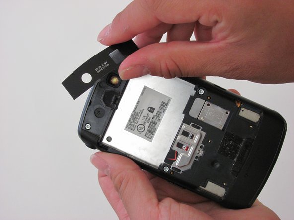

  5. Blackberry Storm 9530 Front Buttons Replacement, Back Speaker: crwdns2935265:05crwdnd2935265:01crwdnd2935265:02crwdne2935265:0 Blackberry Storm 9530 Front Buttons Replacement, Back Speaker: crwdns2935265:05crwdnd2935265:02crwdnd2935265:02crwdne2935265:0
    • Place the opening tool underneath the camera lens' protective plastic cover and pry them apart with gentle force.
    • Make sure the plastic cover has been fully removed by carefully lifting it away from the device with your fingers.

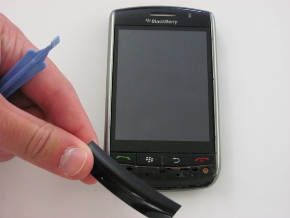

  6. Blackberry Storm 9530 Front Buttons Replacement: crwdns2935265:06crwdnd2935265:01crwdnd2935265:02crwdne2935265:0 Blackberry Storm 9530 Front Buttons Replacement: crwdns2935265:06crwdnd2935265:02crwdnd2935265:02crwdne2935265:0
    • Flip the device so that the touchscreen and Blackberry logo is facing you.
    • Place the opening tool underneath the front plastic cover located below the buttons with red and green phone symbols.
    • Lift and remove the plastic cover once the opening tool is in place. Make sure the plastic cover can be fully detached from the rest of the device.

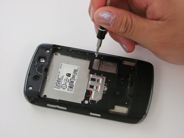

  7. Blackberry Storm 9530 Front Buttons Replacement: crwdns2935265:07crwdnd2935265:01crwdnd2935265:02crwdne2935265:0 Blackberry Storm 9530 Front Buttons Replacement: crwdns2935265:07crwdnd2935265:02crwdnd2935265:02crwdne2935265:0
    • Remove the two bronze Torx T6 3 mm screws below the red and green phone symbols.
  8. Blackberry Storm 9530 Front Buttons Replacement: crwdns2935265:08crwdnd2935265:01crwdnd2935265:02crwdne2935265:0 Blackberry Storm 9530 Front Buttons Replacement: crwdns2935265:08crwdnd2935265:02crwdnd2935265:02crwdne2935265:0
    • Remove the four silver Torx T6 3 mm screws on the back of the device.
  9. Blackberry Storm 9530 Front Buttons Replacement: crwdns2935265:09crwdnd2935265:01crwdnd2935265:02crwdne2935265:0 Blackberry Storm 9530 Front Buttons Replacement: crwdns2935265:09crwdnd2935265:02crwdnd2935265:02crwdne2935265:0
    • Pry the opening tool into the slit between the two plastic sides of the device to separate the back panel from the front panel.
    • Slide the opening tool across the slit until you are left with two, separated front and back panels.

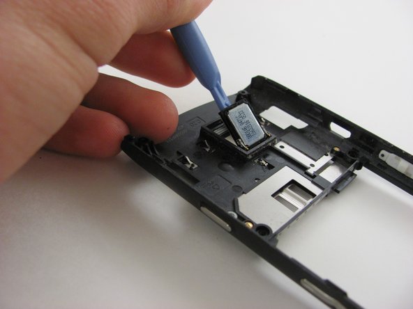

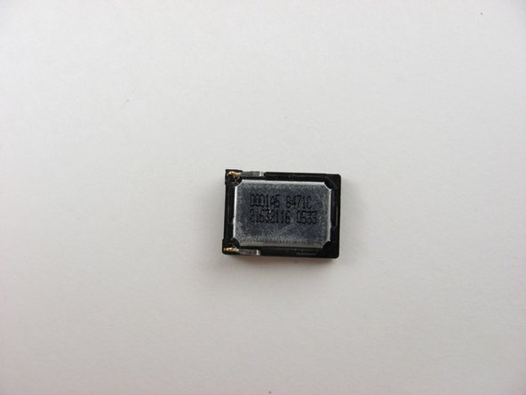

  10. Blackberry Storm 9530 Front Buttons Replacement: crwdns2935265:010crwdnd2935265:01crwdnd2935265:01crwdne2935265:0
    • Locate the silver speaker marked with numbers and letters on the back panel of the device.
  11. Blackberry Storm 9530 Front Buttons Replacement: crwdns2935265:011crwdnd2935265:01crwdnd2935265:03crwdne2935265:0 Blackberry Storm 9530 Front Buttons Replacement: crwdns2935265:011crwdnd2935265:02crwdnd2935265:03crwdne2935265:0 Blackberry Storm 9530 Front Buttons Replacement: crwdns2935265:011crwdnd2935265:03crwdnd2935265:03crwdne2935265:0
    • Place the opening tool underneath the silver speaker component.
    • Use the opening tool to lift the speaker off of the panel with light force.
    • Set the speaker aside once it has been fully removed.
    • When removing speakers, replacing or re-inserting them may result in looseness. This means that during re-assembly they may fall out or shift. An adhesive may be necessary to keep the speaker in place.

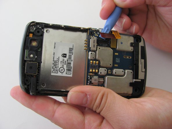

  12. Blackberry Storm 9530 Front Buttons Replacement, Motherboard: crwdns2935265:012crwdnd2935265:01crwdnd2935265:02crwdne2935265:0 Blackberry Storm 9530 Front Buttons Replacement, Motherboard: crwdns2935265:012crwdnd2935265:02crwdnd2935265:02crwdne2935265:0
    • Locate the red tabbed pin strip connected to the motherboard. The red tabbed pin strip is located on the right-hand side of the back of the phone.
    • Disconnect the red tabbed pin strip from the motherboard by inserting the opening tool under the side of the tab and gently pulling upwards toward you.
  13. Blackberry Storm 9530 Front Buttons Replacement: crwdns2935265:013crwdnd2935265:01crwdnd2935265:03crwdne2935265:0 Blackberry Storm 9530 Front Buttons Replacement: crwdns2935265:013crwdnd2935265:02crwdnd2935265:03crwdne2935265:0 Blackberry Storm 9530 Front Buttons Replacement: crwdns2935265:013crwdnd2935265:03crwdnd2935265:03crwdne2935265:0
    • Locate the yellow tabbed pin strip which is directly next to the original location of the red tabbed pin strip.
    • Disconnect the yellow tabbed pin strip from the motherboard using the same technique used to disconnect the red tabbed pin strip in the previous step.

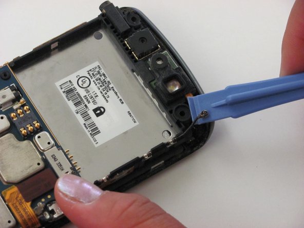

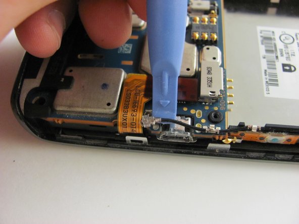

  14. Blackberry Storm 9530 Front Buttons Replacement: crwdns2935265:014crwdnd2935265:01crwdnd2935265:02crwdne2935265:0 Blackberry Storm 9530 Front Buttons Replacement: crwdns2935265:014crwdnd2935265:02crwdnd2935265:02crwdne2935265:0
    • Disconnect the antenna cable located at the top right corner of the black panel using the opening tool.
    • Insert the opening tool underneath the side of the antenna connection, and gently pull upwards to disconnect the cable.
  15. Blackberry Storm 9530 Front Buttons Replacement: crwdns2935265:015crwdnd2935265:01crwdnd2935265:03crwdne2935265:0 Blackberry Storm 9530 Front Buttons Replacement: crwdns2935265:015crwdnd2935265:02crwdnd2935265:03crwdne2935265:0 Blackberry Storm 9530 Front Buttons Replacement: crwdns2935265:015crwdnd2935265:03crwdnd2935265:03crwdne2935265:0
    • Locate the second antenna connection toward the middle right area of the back panel. It is found in the corner where the red and yellow tabbed pin strips met.
    • Remove the antenna connection using the same method done in the previous, top antenna removal step.
    • Loosen the bottom metal cable grip (which pins down the cable) to separate the antenna from the motherboard entirely.

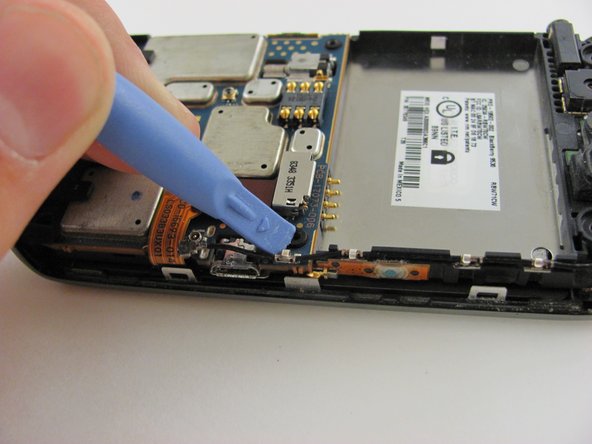

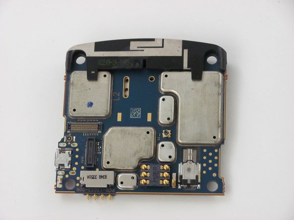

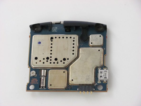

  16. Blackberry Storm 9530 Front Buttons Replacement: crwdns2935265:016crwdnd2935265:01crwdnd2935265:03crwdne2935265:0 Blackberry Storm 9530 Front Buttons Replacement: crwdns2935265:016crwdnd2935265:02crwdnd2935265:03crwdne2935265:0 Blackberry Storm 9530 Front Buttons Replacement: crwdns2935265:016crwdnd2935265:03crwdnd2935265:03crwdne2935265:0
    • Remove the entire motherboard now that all the components holding it down have been removed or disconnected.
    • Grip the top right edge of the motherboard with your fingers and remove it by pulling it out gently.

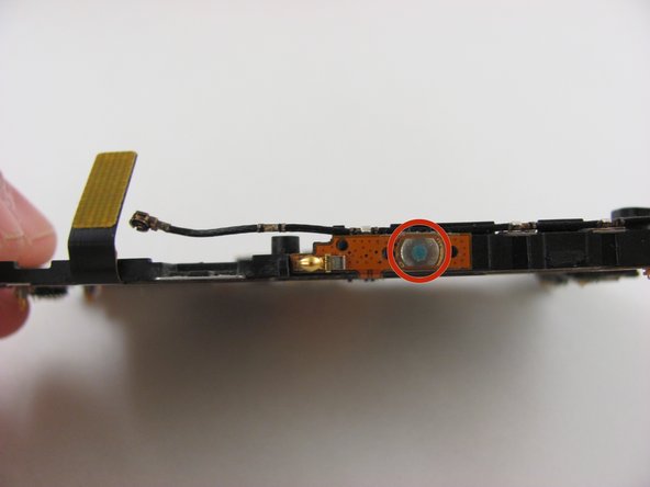

  17. Blackberry Storm 9530 Front Buttons Replacement, Volume Control and Convenience Key Buttons: crwdns2935265:017crwdnd2935265:01crwdnd2935265:02crwdne2935265:0 Blackberry Storm 9530 Front Buttons Replacement, Volume Control and Convenience Key Buttons: crwdns2935265:017crwdnd2935265:02crwdnd2935265:02crwdne2935265:0
    • Replace the volume control and convenience key buttons by replacing the entire middle panel.
    • Contact your plan provider or the phone manufacturer for details on obtaining a new panel.

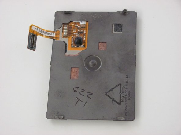

  18. Blackberry Storm 9530 Front Buttons Replacement, LCD/Touchscreen: crwdns2935265:018crwdnd2935265:01crwdnd2935265:03crwdne2935265:0 Blackberry Storm 9530 Front Buttons Replacement, LCD/Touchscreen: crwdns2935265:018crwdnd2935265:02crwdnd2935265:03crwdne2935265:0 Blackberry Storm 9530 Front Buttons Replacement, LCD/Touchscreen: crwdns2935265:018crwdnd2935265:03crwdnd2935265:03crwdne2935265:0
    • Notice that the LCD/touchscreen is placed directly beneath the side button panel.
    • Prepare to remove the The LCD/touchscreen which rests directly on top of the front panel of the phone.
    • Remove the LCD/touchscreen by pulling it off of the front panel once you have located it. No tools are necessary.

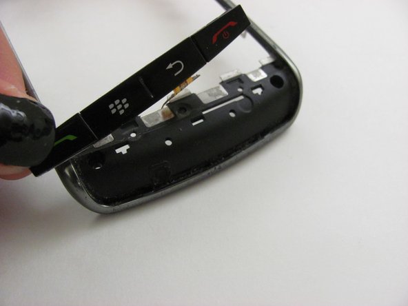

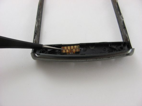

  19. Blackberry Storm 9530 Front Buttons Replacement, Front Buttons: crwdns2935265:019crwdnd2935265:01crwdnd2935265:01crwdne2935265:0
    • If any one of these buttons is broken or needs replacement, then it is possible to replace the whole button strip.
  20. Blackberry Storm 9530 Front Buttons Replacement: crwdns2935265:020crwdnd2935265:01crwdnd2935265:02crwdne2935265:0 Blackberry Storm 9530 Front Buttons Replacement: crwdns2935265:020crwdnd2935265:02crwdnd2935265:02crwdne2935265:0
    • First, the flexible chip on the inside of the frame needs to be detached by using the prying tool.

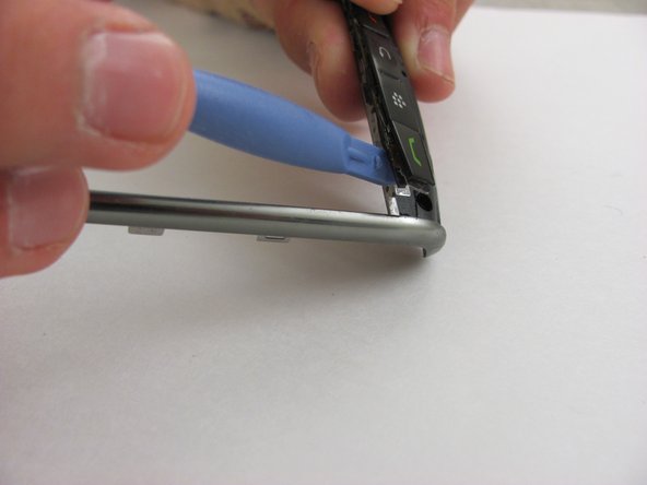

  21. Blackberry Storm 9530 Front Buttons Replacement: crwdns2935265:021crwdnd2935265:01crwdnd2935265:03crwdne2935265:0 Blackberry Storm 9530 Front Buttons Replacement: crwdns2935265:021crwdnd2935265:02crwdnd2935265:03crwdne2935265:0 Blackberry Storm 9530 Front Buttons Replacement: crwdns2935265:021crwdnd2935265:03crwdnd2935265:03crwdne2935265:0
    • Next, the buttons need to be pried from the front panel
