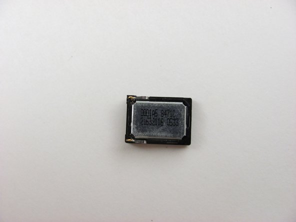

    • Locate the silver speaker marked with numbers and letters on the back panel of the device.
  11. Blackberry Storm 9530 Ear Speaker Replacement: crwdns2935265:011crwdnd2935265:01crwdnd2935265:03crwdne2935265:0 Blackberry Storm 9530 Ear Speaker Replacement: crwdns2935265:011crwdnd2935265:02crwdnd2935265:03crwdne2935265:0 Blackberry Storm 9530 Ear Speaker Replacement: crwdns2935265:011crwdnd2935265:03crwdnd2935265:03crwdne2935265:0
    • Place the opening tool underneath the silver speaker component.
    • Use the opening tool to lift the speaker off of the panel with light force.
    • Set the speaker aside once it has been fully removed.
    • When removing speakers, replacing or re-inserting them may result in looseness. This means that during re-assembly they may fall out or shift. An adhesive may be necessary to keep the speaker in place.

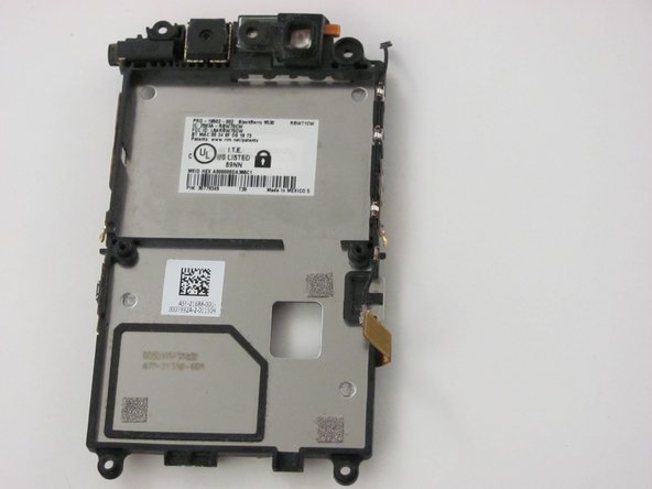

  12. Blackberry Storm 9530 Ear Speaker Replacement, Motherboard: crwdns2935265:012crwdnd2935265:01crwdnd2935265:02crwdne2935265:0 Blackberry Storm 9530 Ear Speaker Replacement, Motherboard: crwdns2935265:012crwdnd2935265:02crwdnd2935265:02crwdne2935265:0
    • Locate the red tabbed pin strip connected to the motherboard. The red tabbed pin strip is located on the right-hand side of the back of the phone.
    • Disconnect the red tabbed pin strip from the motherboard by inserting the opening tool under the side of the tab and gently pulling upwards toward you.

  16. Blackberry Storm 9530 Ear Speaker Replacement: crwdns2935265:016crwdnd2935265:01crwdnd2935265:03crwdne2935265:0 Blackberry Storm 9530 Ear Speaker Replacement: crwdns2935265:016crwdnd2935265:02crwdnd2935265:03crwdne2935265:0 Blackberry Storm 9530 Ear Speaker Replacement: crwdns2935265:016crwdnd2935265:03crwdnd2935265:03crwdne2935265:0
    • Remove the entire motherboard now that all the components holding it down have been removed or disconnected.
    • Grip the top right edge of the motherboard with your fingers and remove it by pulling it out gently.

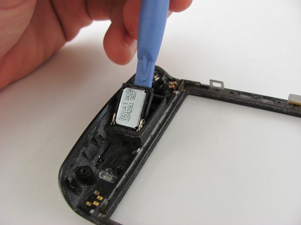

  20. Blackberry Storm 9530 Ear Speaker Replacement, Ear Speaker: crwdns2935265:020crwdnd2935265:01crwdnd2935265:03crwdne2935265:0 Blackberry Storm 9530 Ear Speaker Replacement, Ear Speaker: crwdns2935265:020crwdnd2935265:02crwdnd2935265:03crwdne2935265:0 Blackberry Storm 9530 Ear Speaker Replacement, Ear Speaker: crwdns2935265:020crwdnd2935265:03crwdnd2935265:03crwdne2935265:0
    • First locate the speaker in the top right corner of the front panel
    • Next, place your plastic prying tool underneath the speaker and slowing lift.
    • You may have to be a little forceful with the speaker, because it can sometimes be hard to get out.
    • When removing speakers, replacing or re-inserting them may result in looseness. This means that during re-assembly they may fall out or shift. Glue may be necessary to keep the speaker in place.
