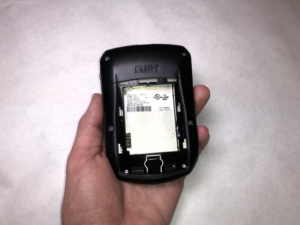

    • Push the release button down and away from the device.
    • Slide the cover off toward the bottom of the device, revealing the battery compartment.
  2. Blackberry RIM 7250 Side Button Replacement: crwdns2935265:02crwdnd2935265:01crwdnd2935265:03crwdne2935265:0 Blackberry RIM 7250 Side Button Replacement: crwdns2935265:02crwdnd2935265:02crwdnd2935265:03crwdne2935265:0 Blackberry RIM 7250 Side Button Replacement: crwdns2935265:02crwdnd2935265:03crwdnd2935265:03crwdne2935265:0

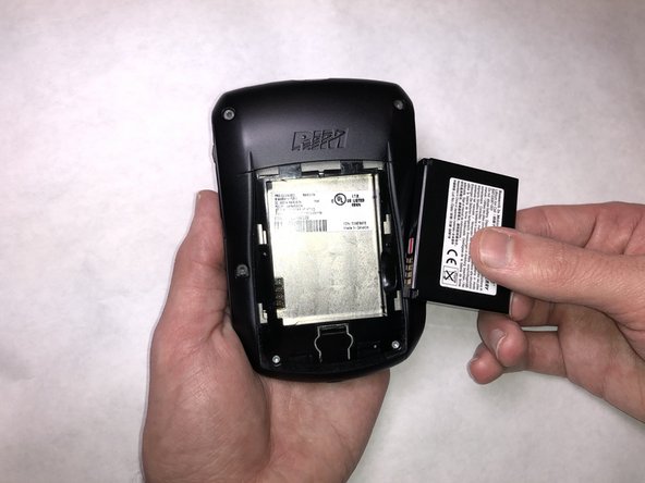

    • Place your finger in the groove next to the battery.
    • Lift your finger up to eject the battery from the battery compartment.
  3. Blackberry RIM 7250 Side Button Replacement: crwdns2935265:03crwdnd2935265:01crwdnd2935265:03crwdne2935265:0 Blackberry RIM 7250 Side Button Replacement: crwdns2935265:03crwdnd2935265:02crwdnd2935265:03crwdne2935265:0 Blackberry RIM 7250 Side Button Replacement: crwdns2935265:03crwdnd2935265:03crwdnd2935265:03crwdne2935265:0
    • Remove the battery from the compartment.

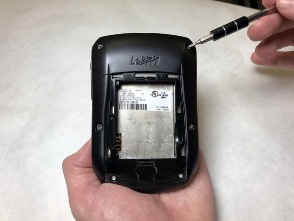

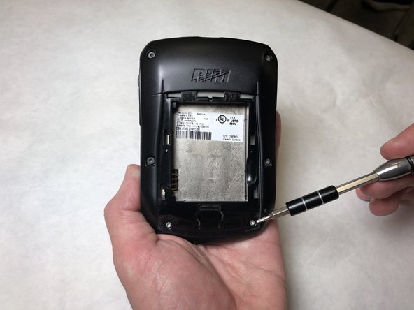

  4. Blackberry RIM 7250 Side Button Replacement, Back Housing: crwdns2935265:04crwdnd2935265:01crwdnd2935265:02crwdne2935265:0 Blackberry RIM 7250 Side Button Replacement, Back Housing: crwdns2935265:04crwdnd2935265:02crwdnd2935265:02crwdne2935265:0
    • Remove the four 10.7 mm Torx T6 screws.
  5. Blackberry RIM 7250 Side Button Replacement: crwdns2935265:05crwdnd2935265:01crwdnd2935265:02crwdne2935265:0 Blackberry RIM 7250 Side Button Replacement: crwdns2935265:05crwdnd2935265:02crwdnd2935265:02crwdne2935265:0
    • Remove the two 5 mm Torx T6 screws.

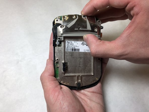

  6. Blackberry RIM 7250 Side Button Replacement: crwdns2935265:06crwdnd2935265:01crwdnd2935265:01crwdne2935265:0
    • Hold the phone with one hand, with the bottom facing toward you.
    • For both clips, insert the plastic opening tool and push away from you.
    • You will hear a clicking sound for each clip that is released.
  7. Blackberry RIM 7250 Side Button Replacement: crwdns2935265:07crwdnd2935265:01crwdnd2935265:03crwdne2935265:0 Blackberry RIM 7250 Side Button Replacement: crwdns2935265:07crwdnd2935265:02crwdnd2935265:03crwdne2935265:0 Blackberry RIM 7250 Side Button Replacement: crwdns2935265:07crwdnd2935265:03crwdnd2935265:03crwdne2935265:0
    • Grab the back housing from the bottom and lift the housing away from you.

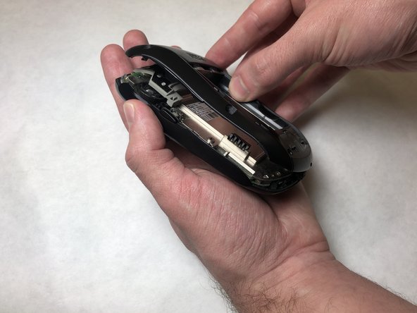

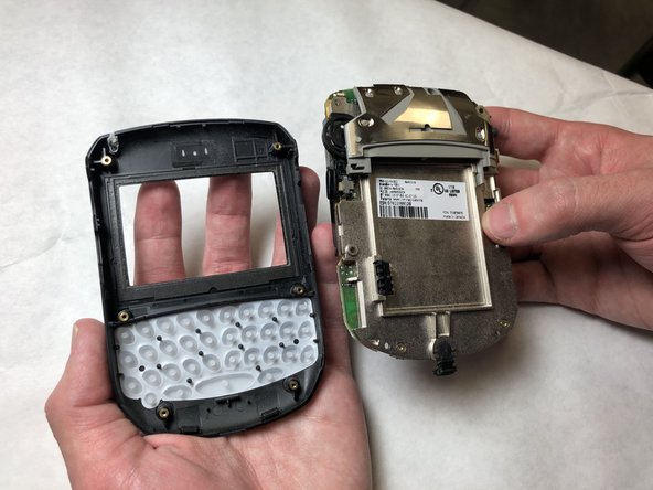

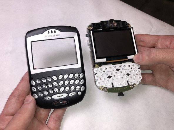

  8. Blackberry RIM 7250 Side Button Replacement, Front Housing: crwdns2935265:08crwdnd2935265:01crwdnd2935265:02crwdne2935265:0 Blackberry RIM 7250 Side Button Replacement, Front Housing: crwdns2935265:08crwdnd2935265:02crwdnd2935265:02crwdne2935265:0
    • Place your thumb on the bottom rectangle and your index finger on the top rectangle.
    • Squeeze your fingers together to release the internals from the front housing.

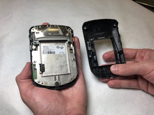

  9. Blackberry RIM 7250 Side Button Replacement: crwdns2935265:09crwdnd2935265:01crwdnd2935265:03crwdne2935265:0 Blackberry RIM 7250 Side Button Replacement: crwdns2935265:09crwdnd2935265:02crwdnd2935265:03crwdne2935265:0 Blackberry RIM 7250 Side Button Replacement: crwdns2935265:09crwdnd2935265:03crwdnd2935265:03crwdne2935265:0
    • Pull the two pieces apart to separate the front housing from the internals.

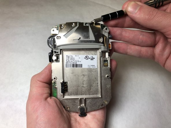

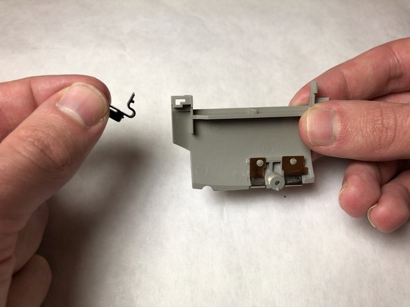

  10. Blackberry RIM 7250 Side Button Replacement, Side Button: crwdns2935265:010crwdnd2935265:01crwdnd2935265:02crwdne2935265:0 Blackberry RIM 7250 Side Button Replacement, Side Button: crwdns2935265:010crwdnd2935265:02crwdnd2935265:02crwdne2935265:0
    • Remove the single 5 mm Torx T6 screw.
  11. Blackberry RIM 7250 Side Button Replacement: crwdns2935265:011crwdnd2935265:01crwdnd2935265:03crwdne2935265:0 Blackberry RIM 7250 Side Button Replacement: crwdns2935265:011crwdnd2935265:02crwdnd2935265:03crwdne2935265:0 Blackberry RIM 7250 Side Button Replacement: crwdns2935265:011crwdnd2935265:03crwdnd2935265:03crwdne2935265:0

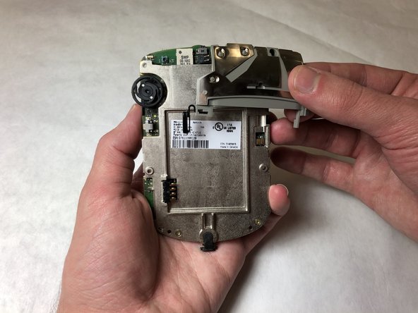

    • Grab side button housing with your thumb and index finger.
    • Remove the side button housing from the internals.

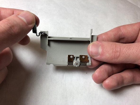

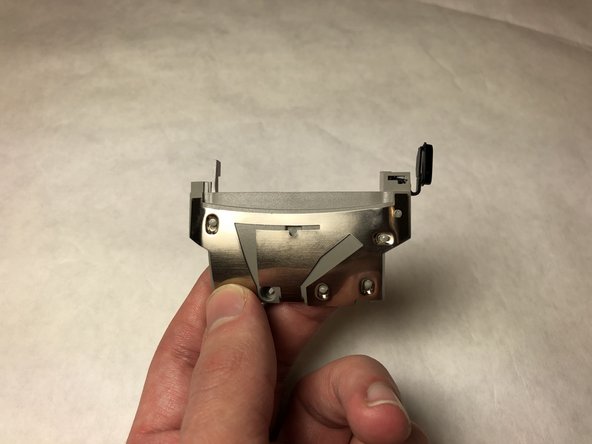

  12. Blackberry RIM 7250 Side Button Replacement: crwdns2935265:012crwdnd2935265:01crwdnd2935265:03crwdne2935265:0 Blackberry RIM 7250 Side Button Replacement: crwdns2935265:012crwdnd2935265:02crwdnd2935265:03crwdne2935265:0 Blackberry RIM 7250 Side Button Replacement: crwdns2935265:012crwdnd2935265:03crwdnd2935265:03crwdne2935265:0
    • Hold the side button housing with one hand and hold the side button with the other.
    • Lift the side button from side button housing.
    • There will be a subtle click when the side button is detached from the side button housing.
