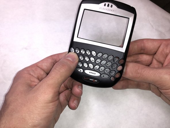

  8. Blackberry RIM 7250 Keyboard Replacement, Front Housing: crwdns2935265:08crwdnd2935265:01crwdnd2935265:02crwdne2935265:0 Blackberry RIM 7250 Keyboard Replacement, Front Housing: crwdns2935265:08crwdnd2935265:02crwdnd2935265:02crwdne2935265:0
    • Place your thumb on the bottom rectangle and your index finger on the top rectangle.
    • Squeeze your fingers together to release the internals from the front housing.
  9. Blackberry RIM 7250 Keyboard Replacement: crwdns2935265:09crwdnd2935265:01crwdnd2935265:03crwdne2935265:0 Blackberry RIM 7250 Keyboard Replacement: crwdns2935265:09crwdnd2935265:02crwdnd2935265:03crwdne2935265:0 Blackberry RIM 7250 Keyboard Replacement: crwdns2935265:09crwdnd2935265:03crwdnd2935265:03crwdne2935265:0
    • Pull the two pieces apart to separate the front housing from the internals.

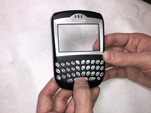

  10. Blackberry RIM 7250 Keyboard Replacement, Keyboard: crwdns2935265:010crwdnd2935265:01crwdnd2935265:03crwdne2935265:0 Blackberry RIM 7250 Keyboard Replacement, Keyboard: crwdns2935265:010crwdnd2935265:02crwdnd2935265:03crwdne2935265:0 Blackberry RIM 7250 Keyboard Replacement, Keyboard: crwdns2935265:010crwdnd2935265:03crwdnd2935265:03crwdne2935265:0
    • Push the keyboard from the front view to separate it from the front housing.

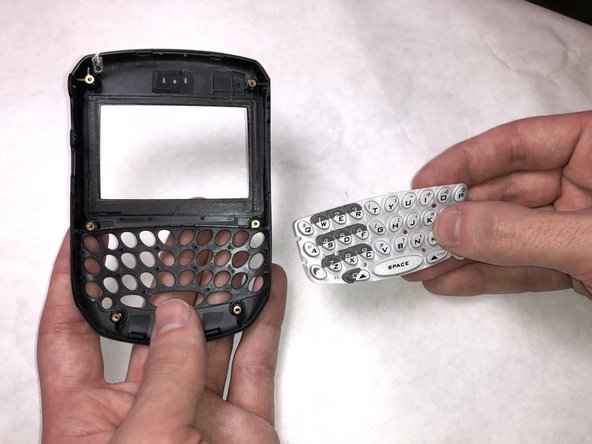

  11. Blackberry RIM 7250 Keyboard Replacement: crwdns2935265:011crwdnd2935265:01crwdnd2935265:02crwdne2935265:0 Blackberry RIM 7250 Keyboard Replacement: crwdns2935265:011crwdnd2935265:02crwdnd2935265:02crwdne2935265:0
    • Hold the front housing with one hand and grab the keyboard with the other.
    • Pull each piece away from each other to remove the keyboard.
