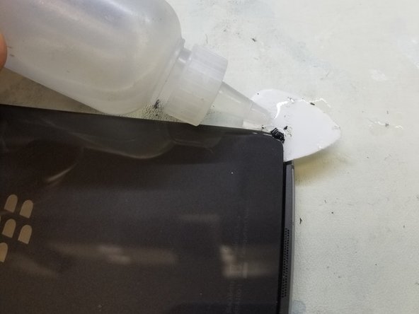

  1. Blackberry DTek 60 Battery Replacement, Detatch The Back Glass: crwdns2935265:01crwdnd2935265:01crwdnd2935265:03crwdne2935265:0 Blackberry DTek 60 Battery Replacement, Detatch The Back Glass: crwdns2935265:01crwdnd2935265:02crwdnd2935265:03crwdne2935265:0 Blackberry DTek 60 Battery Replacement, Detatch The Back Glass: crwdns2935265:01crwdnd2935265:03crwdnd2935265:03crwdne2935265:0
    • Apply heat to the back glass around the edges. you can do this by one of three ways. 1) the iOpener Tool, 2) the hot air gun, and 3) the mobile dryer.
    • Lift the corner as much as possible. Should there be any excessive resistance, be sure to apply more heat.
    • begin working your way through the panel seam. should you encounter and snags, be sure ti dab a minimal amount of alcohal onto your pick, and that will help eat away at the adhesive
