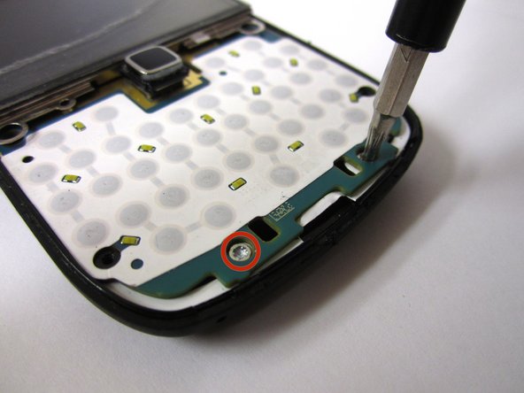

  10. Blackberry Curve 9300 Speaker Replacement, Speaker: crwdns2935265:010crwdnd2935265:01crwdnd2935265:01crwdne2935265:0
    • Locate and remove the two 5mm screws on top of the keyboard base with a T6 Torx screwdriver.

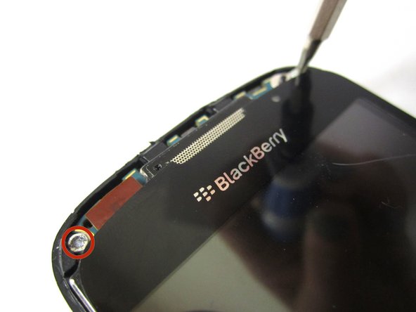

  12. Blackberry Curve 9300 Speaker Replacement: crwdns2935265:012crwdnd2935265:01crwdnd2935265:03crwdne2935265:0 Blackberry Curve 9300 Speaker Replacement: crwdns2935265:012crwdnd2935265:02crwdnd2935265:03crwdne2935265:0 Blackberry Curve 9300 Speaker Replacement: crwdns2935265:012crwdnd2935265:03crwdnd2935265:03crwdne2935265:0
    • Remove the four 5mm screws on the top and bottom of phone with a T6 Torx screwdriver

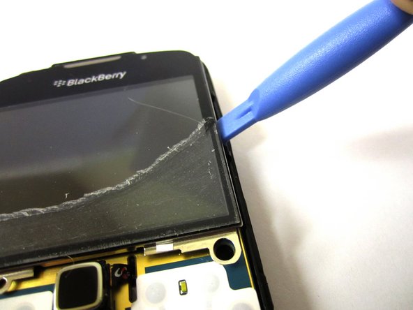

  13. Blackberry Curve 9300 Speaker Replacement: crwdns2935265:013crwdnd2935265:01crwdnd2935265:02crwdne2935265:0 Blackberry Curve 9300 Speaker Replacement: crwdns2935265:013crwdnd2935265:02crwdnd2935265:02crwdne2935265:0
    • Using a prying tool, find the crease below the screen.
    • Insert where shown and use the tool to unclip the two sides of screen from body.
    • Prying tool goes approximately midway between the top and bottom edge of the screen.

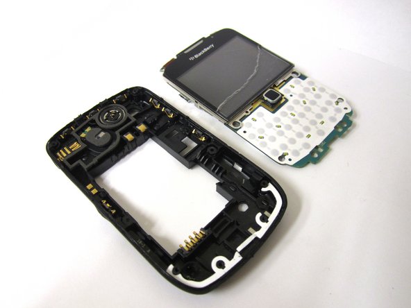

  15. Blackberry Curve 9300 Speaker Replacement: crwdns2935265:015crwdnd2935265:01crwdnd2935265:01crwdne2935265:0

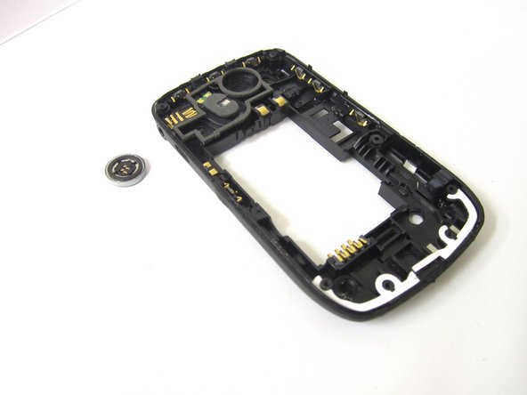

    • Insert tweezers into the small holes on the top of the speaker.
  16. Blackberry Curve 9300 Speaker Replacement: crwdns2935265:016crwdnd2935265:01crwdnd2935265:02crwdne2935265:0 Blackberry Curve 9300 Speaker Replacement: crwdns2935265:016crwdnd2935265:02crwdnd2935265:02crwdne2935265:0
    • Lift the speaker up to remove the speaker from phone.
