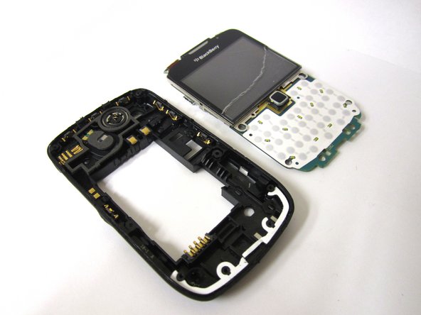

  8. Blackberry Curve 9300 Screen Replacement: crwdns2935265:08crwdnd2935265:01crwdnd2935265:01crwdne2935265:0
    • Lift and remove the frame.
  9. Blackberry Curve 9300 Screen Replacement: crwdns2935265:09crwdnd2935265:01crwdnd2935265:01crwdne2935265:0
    • Lift and remove the keyboard.

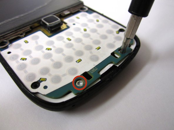

  10. Blackberry Curve 9300 Screen Replacement, Screen: crwdns2935265:010crwdnd2935265:01crwdnd2935265:01crwdne2935265:0
    • Locate and remove the two 5mm screws on top of keyboard base using the T6 Torx screwdriver

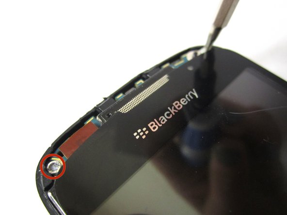

  12. Blackberry Curve 9300 Screen Replacement: crwdns2935265:012crwdnd2935265:01crwdnd2935265:03crwdne2935265:0 Blackberry Curve 9300 Screen Replacement: crwdns2935265:012crwdnd2935265:02crwdnd2935265:03crwdne2935265:0 Blackberry Curve 9300 Screen Replacement: crwdns2935265:012crwdnd2935265:03crwdnd2935265:03crwdne2935265:0
    • Locate and remove the four 5mm screws on the top and bottom of the phone with a T6 Torx screwdriver

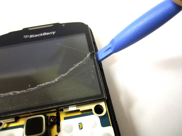

  13. Blackberry Curve 9300 Screen Replacement: crwdns2935265:013crwdnd2935265:01crwdnd2935265:02crwdne2935265:0 Blackberry Curve 9300 Screen Replacement: crwdns2935265:013crwdnd2935265:02crwdnd2935265:02crwdne2935265:0
    • Use a plastic opening tool to find the crease below the screen.
    • Insert where shown and use the tool to unclip the two sides of screen from body.
    • The opening tool goes approximately midway between the top and bottom edge of the screen.

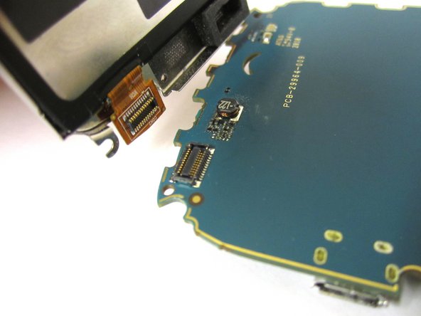

  15. Blackberry Curve 9300 Screen Replacement: crwdns2935265:015crwdnd2935265:01crwdnd2935265:03crwdne2935265:0 Blackberry Curve 9300 Screen Replacement: crwdns2935265:015crwdnd2935265:02crwdnd2935265:03crwdne2935265:0 Blackberry Curve 9300 Screen Replacement: crwdns2935265:015crwdnd2935265:03crwdnd2935265:03crwdne2935265:0
    • Use a plastic opening tool to detach the ribbon cable from the top left corner of the screen, and separate the screen from the motherboard.
