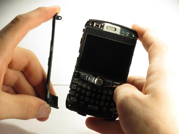

    • Gently pry off the side casings from the top.
    • The side casings cannot be fully removed yet because they are screwed on at the bottom.
    • You will not need to remove the sides on the bottom.

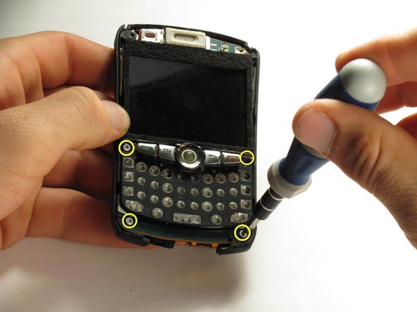

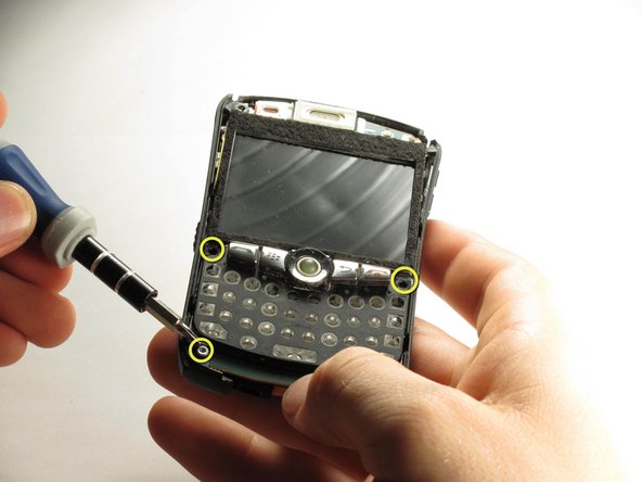

  8. Blackberry Curve 8320 Speaker Replacement, Speaker: crwdns2935265:08crwdnd2935265:01crwdnd2935265:03crwdne2935265:0 Blackberry Curve 8320 Speaker Replacement, Speaker: crwdns2935265:08crwdnd2935265:02crwdnd2935265:03crwdne2935265:0 Blackberry Curve 8320 Speaker Replacement, Speaker: crwdns2935265:08crwdnd2935265:03crwdnd2935265:03crwdne2935265:0
    • Use a T6 Torx screwdriver to remove the four screws located on the corners of the keyboard frame.
    • The screws are 6mm long.
  9. Blackberry Curve 8320 Speaker Replacement: crwdns2935265:09crwdnd2935265:01crwdnd2935265:02crwdne2935265:0 Blackberry Curve 8320 Speaker Replacement: crwdns2935265:09crwdnd2935265:02crwdnd2935265:02crwdne2935265:0
    • After the bottom two screws have been removed the side casings can be removed.

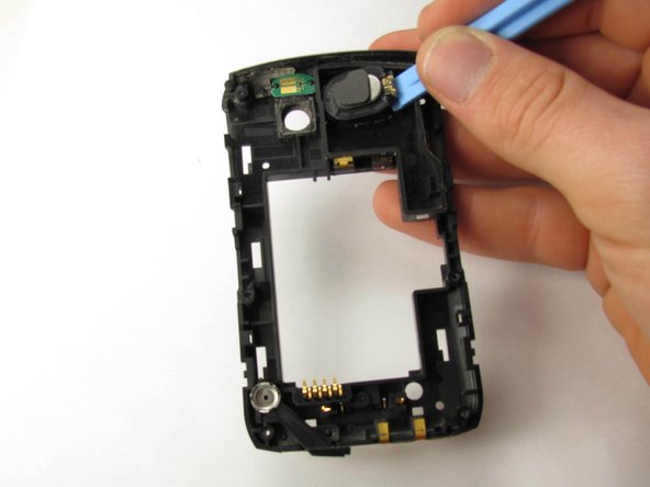

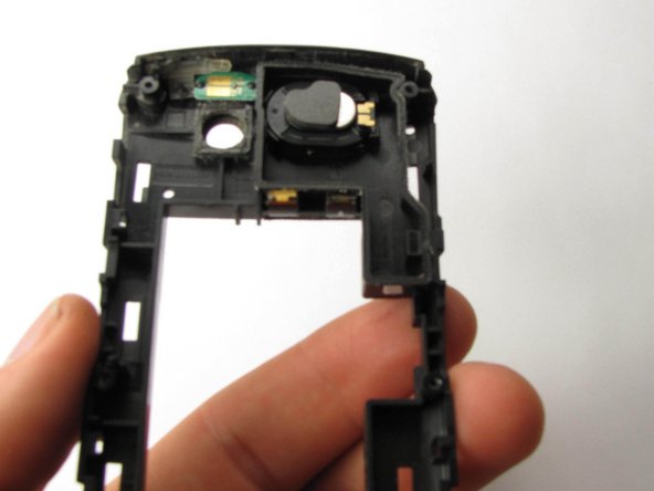

  10. Blackberry Curve 8320 Speaker Replacement: crwdns2935265:010crwdnd2935265:01crwdnd2935265:03crwdne2935265:0 Blackberry Curve 8320 Speaker Replacement: crwdns2935265:010crwdnd2935265:02crwdnd2935265:03crwdne2935265:0 Blackberry Curve 8320 Speaker Replacement: crwdns2935265:010crwdnd2935265:03crwdnd2935265:03crwdne2935265:0
    • Remove the back case.
    • The speaker is located on the back case.
