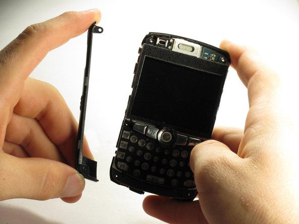

  5. Blackberry Curve 8320 LCD Screen Replacement: crwdns2935265:05crwdnd2935265:01crwdnd2935265:02crwdne2935265:0 Blackberry Curve 8320 LCD Screen Replacement: crwdns2935265:05crwdnd2935265:02crwdnd2935265:02crwdne2935265:0
    • Gently pry off the side casings from the top.
    • The side casings cannot be fully removed yet because they are screwed on at the bottom.
    • You will not need to remove the sides on the bottom.

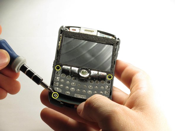

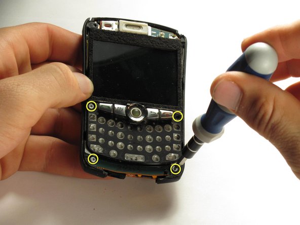

  8. Blackberry Curve 8320 LCD Screen Replacement, LCD Screen: crwdns2935265:08crwdnd2935265:01crwdnd2935265:03crwdne2935265:0 Blackberry Curve 8320 LCD Screen Replacement, LCD Screen: crwdns2935265:08crwdnd2935265:02crwdnd2935265:03crwdne2935265:0 Blackberry Curve 8320 LCD Screen Replacement, LCD Screen: crwdns2935265:08crwdnd2935265:03crwdnd2935265:03crwdne2935265:0
    • Use a T6 Torx screwdriver to remove the four screws located on the corners of the keyboard frame.
    • The screws are 6mm long.
  9. Blackberry Curve 8320 LCD Screen Replacement: crwdns2935265:09crwdnd2935265:01crwdnd2935265:02crwdne2935265:0 Blackberry Curve 8320 LCD Screen Replacement: crwdns2935265:09crwdnd2935265:02crwdnd2935265:02crwdne2935265:0
    • After the bottom two screws have been removed the side casings can be removed.

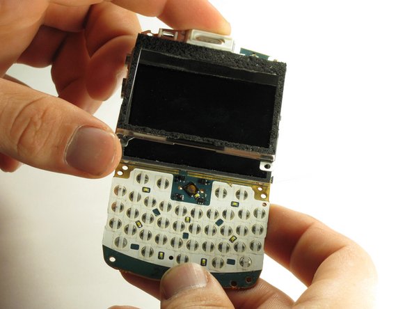

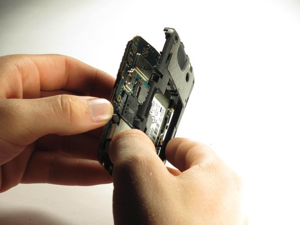

  10. Blackberry Curve 8320 LCD Screen Replacement: crwdns2935265:010crwdnd2935265:01crwdnd2935265:03crwdne2935265:0 Blackberry Curve 8320 LCD Screen Replacement: crwdns2935265:010crwdnd2935265:02crwdnd2935265:03crwdne2935265:0 Blackberry Curve 8320 LCD Screen Replacement: crwdns2935265:010crwdnd2935265:03crwdnd2935265:03crwdne2935265:0
    • When all four screws are removed, the keyboard frame, screen housing, screen, and back casing can be separated.
    • The screen frame hooks on to the top of the motherboard with a small tab on the motherboard.

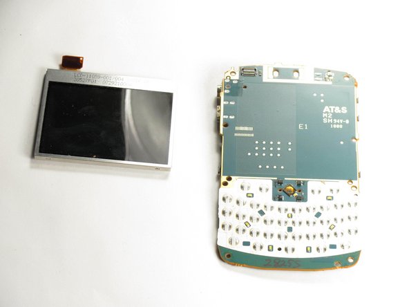

  11. Blackberry Curve 8320 LCD Screen Replacement: crwdns2935265:011crwdnd2935265:01crwdnd2935265:01crwdne2935265:0
    • Place the motherboard on a flat surface with the LCD screen face up.

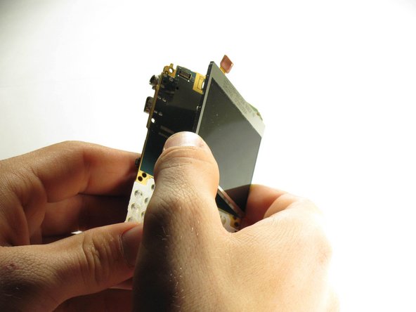

  12. Blackberry Curve 8320 LCD Screen Replacement: crwdns2935265:012crwdnd2935265:01crwdnd2935265:03crwdne2935265:0 Blackberry Curve 8320 LCD Screen Replacement: crwdns2935265:012crwdnd2935265:02crwdnd2935265:03crwdne2935265:0 Blackberry Curve 8320 LCD Screen Replacement: crwdns2935265:012crwdnd2935265:03crwdnd2935265:03crwdne2935265:0
    • Using a plastic opening tool, gently pull the connector directly up from the motherboard.
    • Remove the LCD screen from the motherboard.
    • The screen is attached to the motherboard with adhesive.
