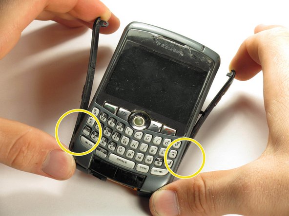

  3. Blackberry Curve 8320 Keyboard Replacement: crwdns2935265:03crwdnd2935265:01crwdnd2935265:02crwdne2935265:0 Blackberry Curve 8320 Keyboard Replacement: crwdns2935265:03crwdnd2935265:02crwdnd2935265:02crwdne2935265:0
    • Gently pry off the side casings from the top.
    • The side casings cannot be fully removed yet because they are screwed on at the bottom.
    • You will not need to remove the sides on the bottom.

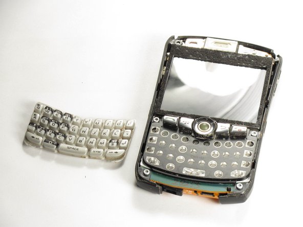

  5. Blackberry Curve 8320 Keyboard Replacement: crwdns2935265:05crwdnd2935265:01crwdnd2935265:01crwdne2935265:0
    • Carefully remove the front panel.
    • You may need to apply some force in removing because the front panel is attached to the rest of the device with adhesive.
  6. Blackberry Curve 8320 Keyboard Replacement, Keyboard: crwdns2935265:06crwdnd2935265:01crwdnd2935265:02crwdne2935265:0 Blackberry Curve 8320 Keyboard Replacement, Keyboard: crwdns2935265:06crwdnd2935265:02crwdnd2935265:02crwdne2935265:0
    • Remove the keyboard.
    • Be careful not to bend or fold the keyboard, as it can break easily.
