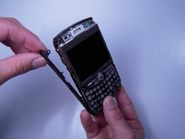

  9. Blackberry Curve 8310 Screen Housing Replacement: crwdns2935265:09crwdnd2935265:01crwdnd2935265:02crwdne2935265:0 Blackberry Curve 8310 Screen Housing Replacement: crwdns2935265:09crwdnd2935265:02crwdnd2935265:02crwdne2935265:0
    • Now remove the left and right side panels.

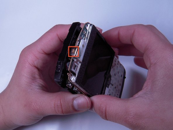

  10. Blackberry Curve 8310 Screen Housing Replacement: crwdns2935265:010crwdnd2935265:01crwdnd2935265:03crwdne2935265:0 Blackberry Curve 8310 Screen Housing Replacement: crwdns2935265:010crwdnd2935265:02crwdnd2935265:03crwdne2935265:0 Blackberry Curve 8310 Screen Housing Replacement: crwdns2935265:010crwdnd2935265:03crwdnd2935265:03crwdne2935265:0
    • Remove the keyboard frame.
    • Be sure to unhook the screen housing from the motherboard before continuing. Refer to the square indicated in the second picture.
    • Now remove the screen housing.
