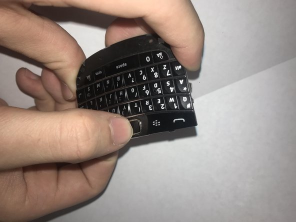

  4. Blackberry Bold 9900 Trackpad Replacement, Keyboard: crwdns2935265:04crwdnd2935265:01crwdnd2935265:02crwdne2935265:0 Blackberry Bold 9900 Trackpad Replacement, Keyboard: crwdns2935265:04crwdnd2935265:02crwdnd2935265:02crwdne2935265:0
    • Lift the bezel at the bottom of the phone up and peel it away from the phone.
  5. Blackberry Bold 9900 Trackpad Replacement: crwdns2935265:05crwdnd2935265:01crwdnd2935265:02crwdne2935265:0 Blackberry Bold 9900 Trackpad Replacement: crwdns2935265:05crwdnd2935265:02crwdnd2935265:02crwdne2935265:0
    • Remove the two exposed screws using the T5 Torx screwdriver.
  6. Blackberry Bold 9900 Trackpad Replacement: crwdns2935265:06crwdnd2935265:01crwdnd2935265:01crwdne2935265:0
    • Now lever the keyboard up using the screwdriver in the indicated hole.
  7. Blackberry Bold 9900 Trackpad Replacement: crwdns2935265:07crwdnd2935265:01crwdnd2935265:02crwdne2935265:0 Blackberry Bold 9900 Trackpad Replacement: crwdns2935265:07crwdnd2935265:02crwdnd2935265:02crwdne2935265:0
    • The keyboard is attached via a ribbon cable. Pull the cable up to remove the keyboard.

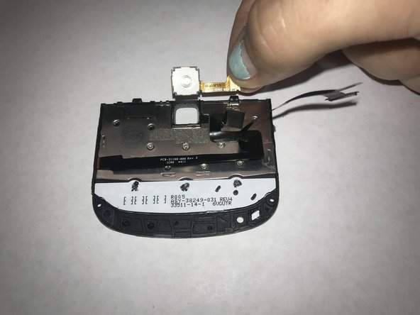

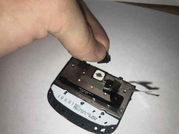

  8. Blackberry Bold 9900 Trackpad Replacement, Trackpad: crwdns2935265:08crwdnd2935265:01crwdnd2935265:03crwdne2935265:0 Blackberry Bold 9900 Trackpad Replacement, Trackpad: crwdns2935265:08crwdnd2935265:02crwdnd2935265:03crwdne2935265:0 Blackberry Bold 9900 Trackpad Replacement, Trackpad: crwdns2935265:08crwdnd2935265:03crwdnd2935265:03crwdne2935265:0
    • Push into the trackpad. This will release the trackpad supporting piece.
  9. Blackberry Bold 9900 Trackpad Replacement: crwdns2935265:09crwdnd2935265:01crwdnd2935265:02crwdne2935265:0 Blackberry Bold 9900 Trackpad Replacement: crwdns2935265:09crwdnd2935265:02crwdnd2935265:02crwdne2935265:0
    • The trackpad is attached via ribbon cable. Pull this cable up in order to release the trackpad.
