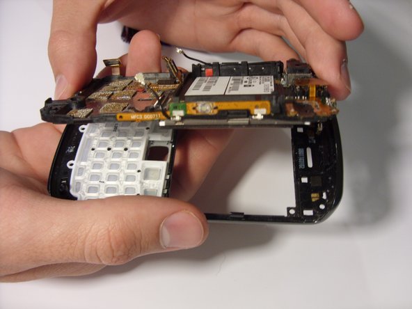

  10. Blackberry Bold 9650 LCD Screen Replacement: crwdns2935265:010crwdnd2935265:01crwdnd2935265:01crwdne2935265:0
    • Using your fingers, carefully lift and remove the mother board.
    • The connectors underneath the mother board are delicate and easily damaged.
  11. Blackberry Bold 9650 LCD Screen Replacement: crwdns2935265:011crwdnd2935265:01crwdnd2935265:01crwdne2935265:0
    • Using a pair of tweezers, remove the three ribbon connectors.
  12. Blackberry Bold 9650 LCD Screen Replacement: crwdns2935265:012crwdnd2935265:01crwdnd2935265:01crwdne2935265:0
    • Remove the mother board by lifting the board upward.
