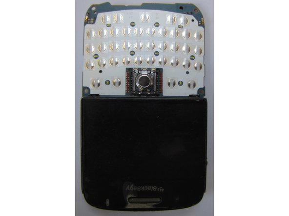

  7. Blackberry Bold 9000 Keyboard Replacement, Keyboard: crwdns2935265:07crwdnd2935265:01crwdnd2935265:02crwdne2935265:0 Blackberry Bold 9000 Keyboard Replacement, Keyboard: crwdns2935265:07crwdnd2935265:02crwdnd2935265:02crwdne2935265:0
    • With the same plastic opening tool, lift the motherboard up and out.
    • Remove the motherboard assembly from left to right, raise the bottom of the circuit board first, slide back to allow the board to come free of the slot way it is inserted into at the top, and use caution near the audio jack on the right side of the device.
  8. Blackberry Bold 9000 Keyboard Replacement: crwdns2935265:08crwdnd2935265:01crwdnd2935265:01crwdne2935265:0
    • Holding the front cover, push the keyboard in with your thumbs.
    • Start at the top two corners, then repeat with the bottom two corners.

This article describes removing the keypad button set and shows/describes nothing of replacing the keyboard electronics which controls the functionality of the keypad buttons. The keyboard electronics are on the reverse side of the motherboard assembly as seen in step 7. They are sealed beneath a sheet of plastic that contain a set of contact pads for the keyboard button set.
Most problems with this keyboard are likely associated with certain keys not functioning at all or responding in ways other than that intended. Repair/replacement looks improbable.
Ross - crwdns2934203:0crwdne2934203:0
I had quite a few of the keyboard letters/numbers, spacebar and end call not functioning. Since I had the phone apart I decided to spray all of the keyboard white area and all the gold contact points around the perimeter with an electronic contact cleaner and wiped with a Q-tip. Reassembled it and - WOW - everything worked again. Thank you for the guide.
