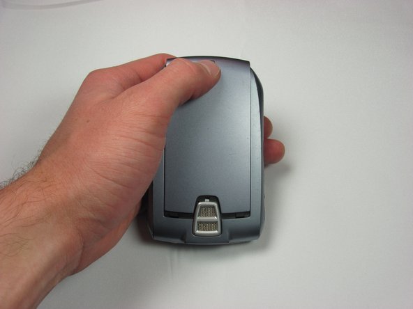

    • The required tools are pictured on the left (Picture 1). The tools are, left to right, spudger, T6 screwdriver, plastic opening tool.

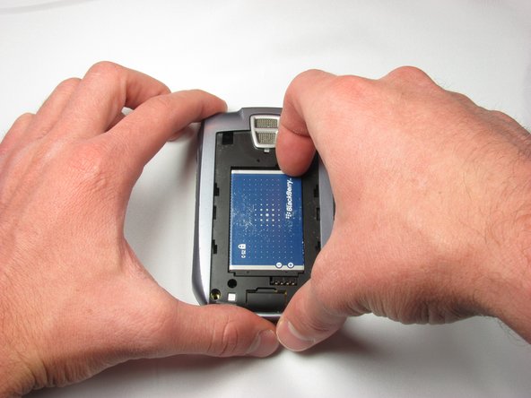

    • Remove the back cover by pushing the button near the bottom of the phone (Picture 2) and sliding the cover off (Picture 3).

    • Using your fingernail, remove the battery by pulling on the notch on the top-right of the battery.

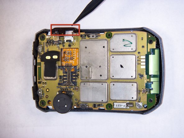

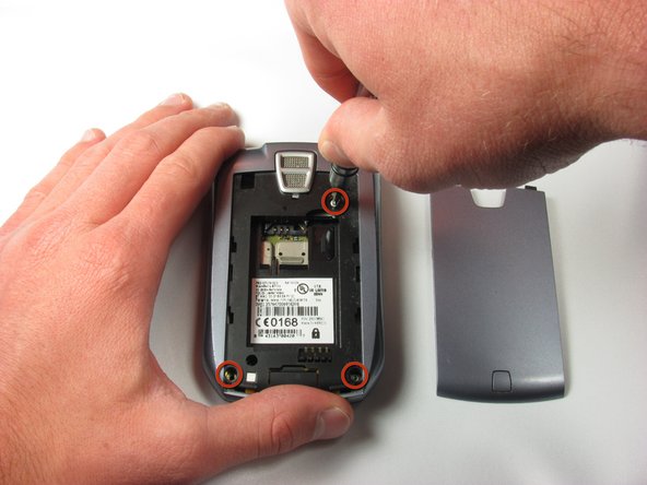

    • Remove the inner back cover by unscrewing all three T6 screws (circled in Picture 1) with a T6 Torx screwdriver.
    • The inner back cover, removed in the next bullet, can be difficult to remove. You may need to use a plastic opening tool. Insert the plastic tool near the top of the phone between the cover and the phone. Gently pry the cover off.
    • Pull the inner back cover from the bottom towards you and up (Picture 2).

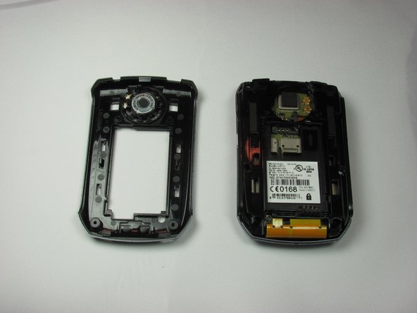

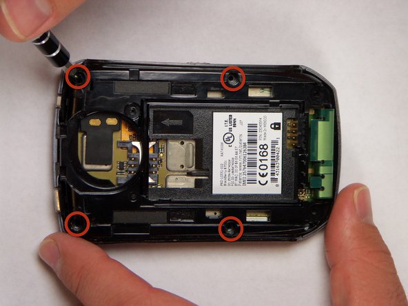

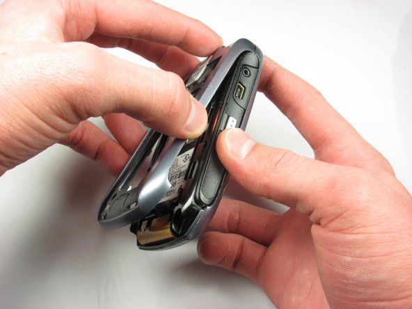

    • Remove the inner cover by unscrewing all four T6 screws with a T6 Torx screwdriver (circled in Picture 1).

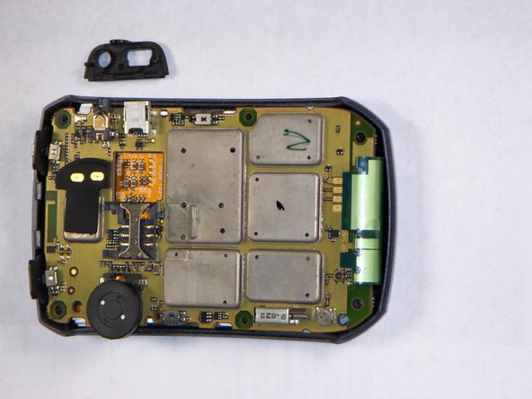

    • A small black piece (circled in Picture 2 and displayed in Picture 3) will fall out when you remove the cover in the next bullet.
    • Lift the inner cover off the phone.

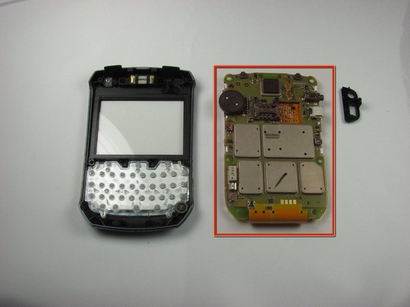

    • The logic board removed in the next bullet is the entire circuit board circled in Picture 2.
    • Remove the logic board by lifting it away the front cover.

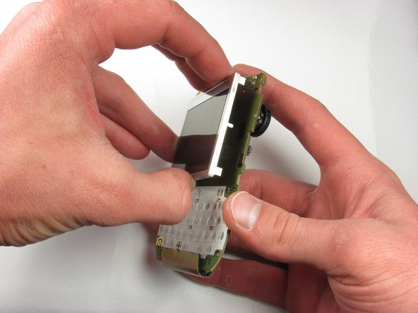

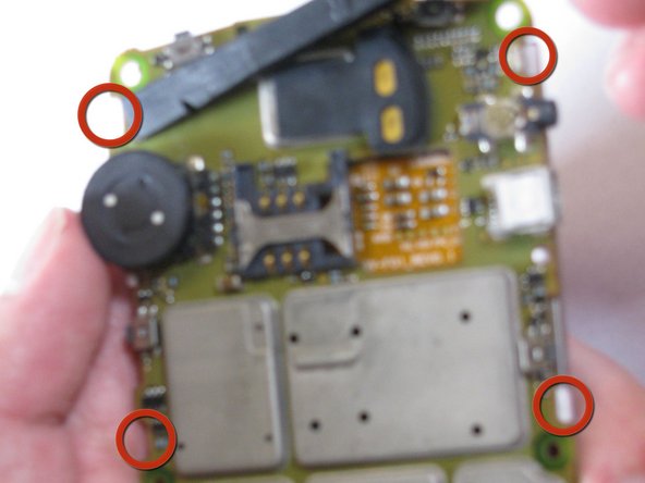

    • The clips disengaged in the next bullet may weaken and break after unclipping them.
    • Detach the display screen from the logic board by using a spudger to unclip the four clips holding the display screen (circled in Picture 1). Gently pull the display screen away from the logic board so that none of the clips are engaged.

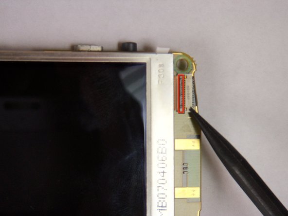

    • The display screen is attached to the logic board by a metal ribbon. Remove the display screen by disengaging the ribbon lock. Use a spudger to push the thin black bar down (circled in Picture 2). Gently pull the display screen and ribbon out of the logic board.

    • Install the new display screen by reattaching it to the logic board. Reinsert the ribbon into the cable lock. Use the spudger to push the thin black bar up (circled in Picture 1).

    • Position the small black piece that fell out in Step 2 against the headphone jack on the side of the phone (circled in Picture 2).
