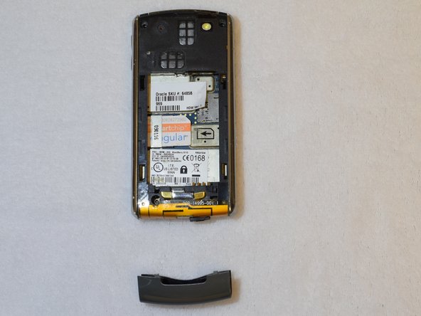

  3. Blackberry 8110 Display Replacement, Removing the bottom cover.: crwdns2935265:03crwdnd2935265:01crwdnd2935265:02crwdne2935265:0 Blackberry 8110 Display Replacement, Removing the bottom cover.: crwdns2935265:03crwdnd2935265:02crwdnd2935265:02crwdne2935265:0
    • Now that the two screws at the top have been removed, take your spudger and locate the two gaps to the left and right of the button that releases the battery cover.
    • With your spudger, carefully wedge it into the gap and pry downwards to release the bottom cover.

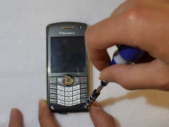

  4. Blackberry 8110 Display Replacement, Removng the screws from the front side.: crwdns2935265:04crwdnd2935265:01crwdnd2935265:02crwdne2935265:0 Blackberry 8110 Display Replacement, Removng the screws from the front side.: crwdns2935265:04crwdnd2935265:02crwdnd2935265:02crwdne2935265:0
    • Turn the phone over so that the screen is facing up. With the bottom cover off, you will be able to locate two 7.5mm Torx #T6 screws in each corner below the keyboard. Carefully remove these.

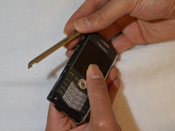

  5. Blackberry 8110 Display Replacement, Taking off the side panels.: crwdns2935265:05crwdnd2935265:01crwdnd2935265:02crwdne2935265:0 Blackberry 8110 Display Replacement, Taking off the side panels.: crwdns2935265:05crwdnd2935265:02crwdnd2935265:02crwdne2935265:0
    • Now that the screws on the front have been removed, take your spudger and wedge it between the trim on the side of the phone, and the phone itself. Carefully pry the trim away from the phone.

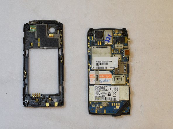

  6. Blackberry 8110 Display Replacement, Removing the back panel.: crwdns2935265:06crwdnd2935265:01crwdnd2935265:02crwdne2935265:0 Blackberry 8110 Display Replacement, Removing the back panel.: crwdns2935265:06crwdnd2935265:02crwdnd2935265:02crwdne2935265:0
    • You are now ready to remove the back panel. In order to do this, locate the two clips on each side of the phone (underneath the trim that you just removed).
    • Once you locate these clips (four in total, two on each side), you should be able to unclip them with your fingers.
    • Be gentle as to not break the clips in doing so.

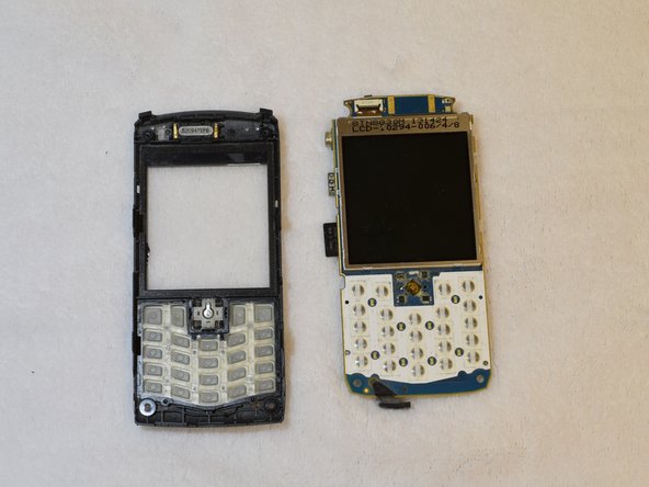

  7. Blackberry 8110 Display Replacement, Removing the front panel.: crwdns2935265:07crwdnd2935265:01crwdnd2935265:02crwdne2935265:0 Blackberry 8110 Display Replacement, Removing the front panel.: crwdns2935265:07crwdnd2935265:02crwdnd2935265:02crwdne2935265:0
    • The front panel is now ready to be removed from the rest of the phone. To do this, just pry the front part (with the keyboard and screen) away from the logic board of the phone with your fingers.

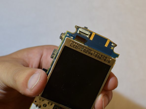

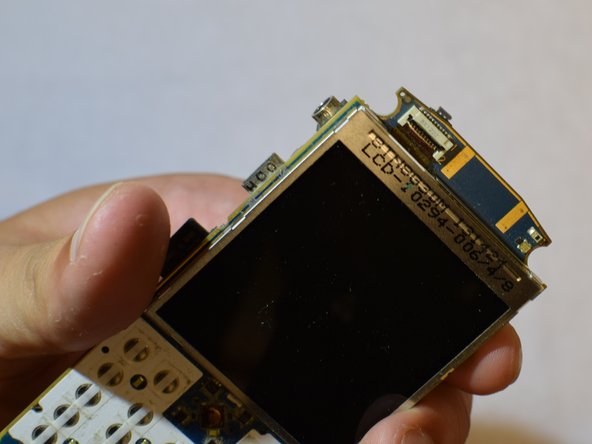

  8. Blackberry 8110 Display Replacement, Disconnecting the display: crwdns2935265:08crwdnd2935265:01crwdnd2935265:02crwdne2935265:0 Blackberry 8110 Display Replacement, Disconnecting the display: crwdns2935265:08crwdnd2935265:02crwdnd2935265:02crwdne2935265:0
    • What is left after removing the panels is the logic board and screen. With the display facing up its connection to the logic board is on the top-left corner.
  9. Blackberry 8110 Display Replacement: crwdns2935265:09crwdnd2935265:01crwdnd2935265:03crwdne2935265:0 Blackberry 8110 Display Replacement: crwdns2935265:09crwdnd2935265:02crwdnd2935265:03crwdne2935265:0 Blackberry 8110 Display Replacement: crwdns2935265:09crwdnd2935265:03crwdnd2935265:03crwdne2935265:0
    • Swing the black tab securing the display cable outwards and away from the logic board to an upright position (perpendicular to the white block). The tab's pivot points are at the center-left and center-right of the white block.

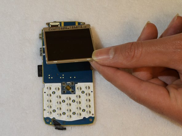

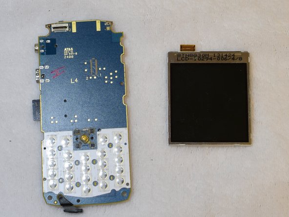

  10. Blackberry 8110 Display Replacement: crwdns2935265:010crwdnd2935265:01crwdnd2935265:02crwdne2935265:0 Blackberry 8110 Display Replacement: crwdns2935265:010crwdnd2935265:02crwdnd2935265:02crwdne2935265:0
    • Remove the display cable down towards the center of the logic board and away from under the black tab. Use a spudger between the display and logic board along all sides to separate the display.
