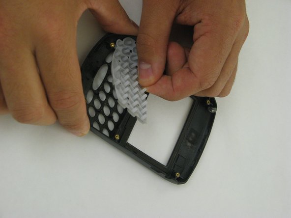

  11. Blackberry 7520 Keypad Replacement, Keypad: crwdns2935265:011crwdnd2935265:01crwdnd2935265:02crwdne2935265:0 Blackberry 7520 Keypad Replacement, Keypad: crwdns2935265:011crwdnd2935265:02crwdnd2935265:02crwdne2935265:0
    • After removing the faceplate of the BlackBerry, place it facing down on a table as shown.
    • Using tweezers if needed, grip the keypad by one of the plastic nubs and pull it off of the pins.
    • Alternatively, you can pop the keypad out by holding the faceplate face-up and pressing the keys down. Be sure to catch the keypad when it falls out.

  13. Blackberry 7520 Keypad Replacement: crwdns2935265:013crwdnd2935265:01crwdnd2935265:01crwdne2935265:0
    • To place the new or cleaned keypad in the faceplate, hold the faceplate in one hand face-down and grab the keypad by the edges in your other hand.
    • Align the holes in the keypad over the black pins in the faceplate and press down on the keypad until it is firmly in place. Flip the faceplate over to make sure that the keys are properly aligned.
