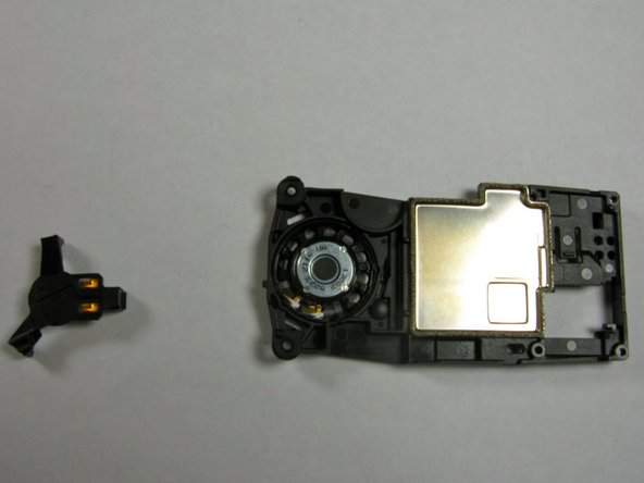

  8. Blackberry 7105t Speaker Replacement, Speaker: crwdns2935265:08crwdnd2935265:01crwdnd2935265:02crwdne2935265:0 Blackberry 7105t Speaker Replacement, Speaker: crwdns2935265:08crwdnd2935265:02crwdnd2935265:02crwdne2935265:0
    • With the speaker facing towards you, use a spudger to unfasten the three clips indicated in the picture.
    • Place the three clips in plastic bag and set aside.
    • Once clips are removed, you will have full access to remove the speaker.
