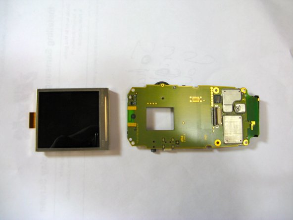

  11. Blackberry 7105t LCD Replacement: crwdns2935265:011crwdnd2935265:01crwdnd2935265:02crwdne2935265:0 Blackberry 7105t LCD Replacement: crwdns2935265:011crwdnd2935265:02crwdnd2935265:02crwdne2935265:0
    • Flip the logic board over to the other side.
    • Use a plastic opening tool unclip the top two clips shown in red, and then the bottom two clips. This releases the screen.
    • Flip logic board over and remove screen.
    • Make sure to hold the screen, it could fall after being unclipped.
  12. Blackberry 7105t LCD Replacement: crwdns2935265:012crwdnd2935265:01crwdnd2935265:01crwdne2935265:0
    • NOTE: If you are not replacing the LCD screen, move on to the next step.
    • After removing the original screen, keep the logic board facing you the way it was.
    • Take the new screen and slip the flexible piece of connecting circuitry under the grey plastic flap that you pried up in step 10.
    • Handle the screen carefully as it is fragile.
    • Push it gently but firmly until it does not move any further to the left, then close the grey flap.
    • After this, the screen can be pushed down and clicked back into place.
    • To reassemble the phone, reverse instructions.
