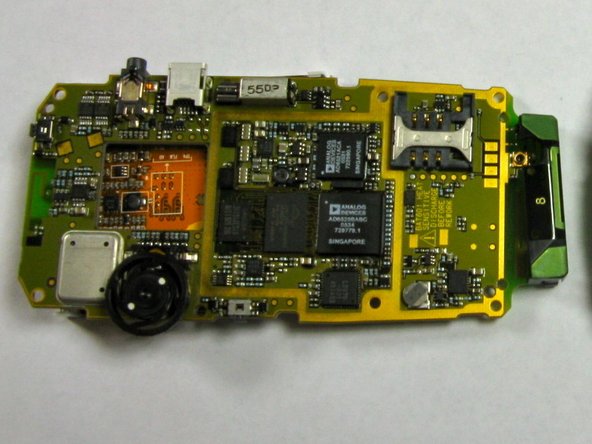

  7. Blackberry 7105t Keyboard Replacement: crwdns2935265:07crwdnd2935265:01crwdnd2935265:01crwdne2935265:0
    • The black battery casing and logic board can now be separated for the following steps.

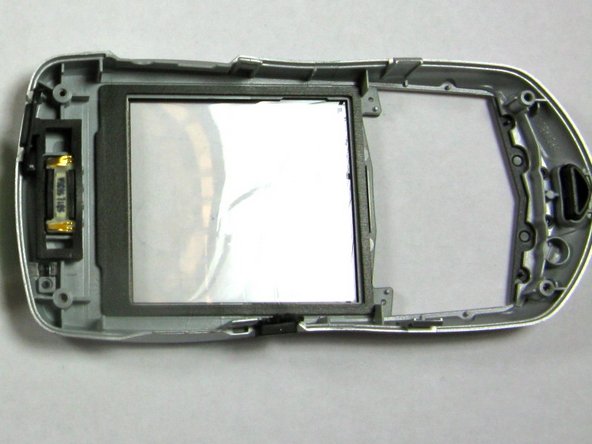

  8. Blackberry 7105t Keyboard Replacement, Second Disassembly: crwdns2935265:08crwdnd2935265:01crwdnd2935265:01crwdne2935265:0
    • The silver piece is not attached to the logic board in any way, and can be taken off by lifting it up with plastic opening tools.
    • Warning: Some of the phones have an adhesive between the silver part and the battery housing, so it could stick to the black piece you just removed.

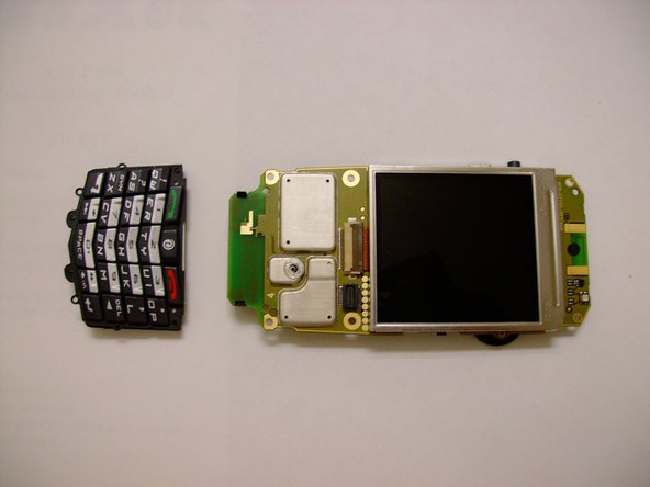

  9. Blackberry 7105t Keyboard Replacement, Keyboard: crwdns2935265:09crwdnd2935265:01crwdnd2935265:02crwdne2935265:0 Blackberry 7105t Keyboard Replacement, Keyboard: crwdns2935265:09crwdnd2935265:02crwdnd2935265:02crwdne2935265:0
    • Use a plastic opening tool to lift up the two black clips indicated in the picture.
    • Hold on to the keyboard while unfastening the clips.
    • The keyboard will detach once the clips are unfastened.
