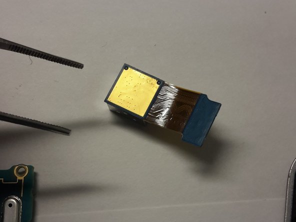

  11. BlackBerry Z30 Middle Frame Replacement, Remove the Rear Camera: crwdns2935265:011crwdnd2935265:01crwdnd2935265:02crwdne2935265:0 BlackBerry Z30 Middle Frame Replacement, Remove the Rear Camera: crwdns2935265:011crwdnd2935265:02crwdnd2935265:02crwdne2935265:0
    • Use a pair of pliers to remove the rear facing camera

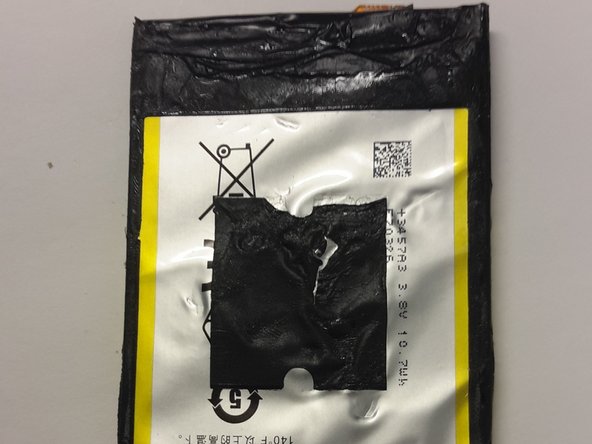

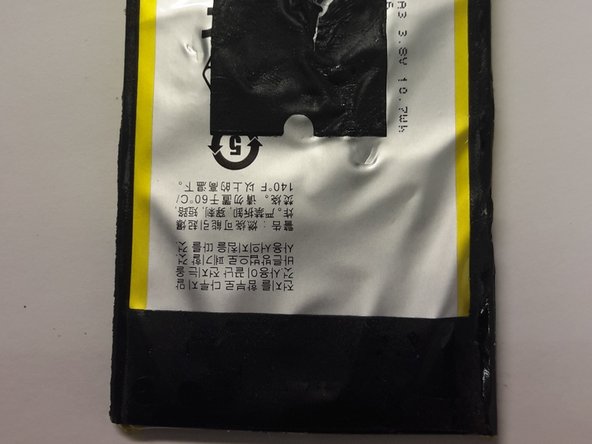

  12. BlackBerry Z30 Middle Frame Replacement, Remove the Battery: crwdns2935265:012crwdnd2935265:01crwdnd2935265:03crwdne2935265:0 BlackBerry Z30 Middle Frame Replacement, Remove the Battery: crwdns2935265:012crwdnd2935265:02crwdnd2935265:03crwdne2935265:0 BlackBerry Z30 Middle Frame Replacement, Remove the Battery: crwdns2935265:012crwdnd2935265:03crwdnd2935265:03crwdne2935265:0
    • If this is the original battery, it might be hold down by VERY strong adhesive on the top, middle and bottom part. Be careful not to damage the battery
    • As pointed in the comments, be careful about the NFC membrane when removing the battery. Use heat to loosen the glue.
