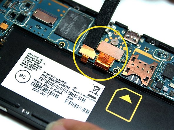

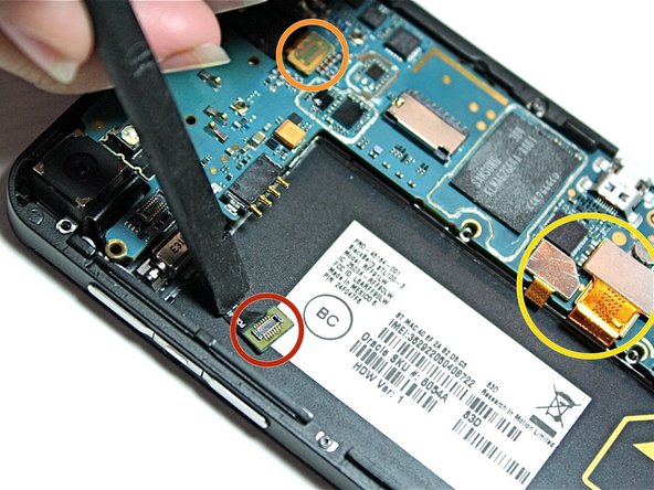

    • Use the spudger to detach the green flat-top connector located under the rear camera. Slowly push the connector up and back. Refer to the first and second images.
    • Use the spudger to detach and lift the orange flat-top connector seen in the second image. Slowly push the connector up and back.
    • Then, detach the remaining three flat-top connectors one at a time to release the motherboard from the housing. The third connector is hidden underneath the largest one.
