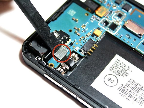

    • Use the nylon spudger, which is a black plastic tool, to avoid any damages on the internal parts of the motherboard.
    • Now that the motherboard is exposed, keep the tool handy for future detachments.
    • With the nylon spudger, slowly lift up and disconnect the green ribbon cable located just below the rear camera.
