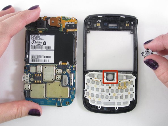

  10. BlackBerry Tour 9630 Trackball Replacement: crwdns2935265:010crwdnd2935265:01crwdnd2935265:01crwdne2935265:0
    • Gently push up on the keyboard from below to remove the front cover frame.
    • Once you remove the front cover, the keypad and trackball will be loose.
  11. BlackBerry Tour 9630 Trackball Replacement: crwdns2935265:011crwdnd2935265:01crwdnd2935265:01crwdne2935265:0
    • Remove the keypad.
  12. BlackBerry Tour 9630 Trackball Replacement, Trackball: crwdns2935265:012crwdnd2935265:01crwdnd2935265:02crwdne2935265:0 BlackBerry Tour 9630 Trackball Replacement, Trackball: crwdns2935265:012crwdnd2935265:02crwdnd2935265:02crwdne2935265:0
    • Remove the trackball.
Mia
