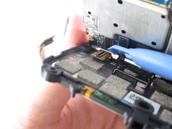

  12. BlackBerry Tour 9630 LCD Screen Replacement, LCD Screen: crwdns2935265:012crwdnd2935265:01crwdnd2935265:02crwdne2935265:0 BlackBerry Tour 9630 LCD Screen Replacement, LCD Screen: crwdns2935265:012crwdnd2935265:02crwdnd2935265:02crwdne2935265:0
    • Gently lift the motherboard to expose several ribbon cables.
    • Use the small plastic opening tool to disconnect the orange LCD ribbon from the square end of the ribbon cables.
  13. BlackBerry Tour 9630 LCD Screen Replacement: crwdns2935265:013crwdnd2935265:01crwdnd2935265:01crwdne2935265:0
    • Flip the phone over. Using the large plastic opening tool, pry the LCD screen from the motherboard.
    • Replace the LCD screen
    • The LCD screen is held in place with glue.
