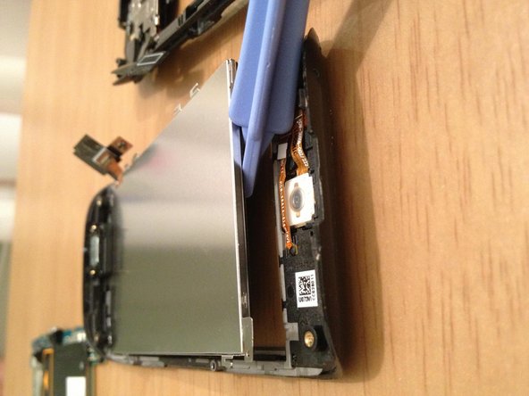

    • There will be a silver bezel around the edge (the dog ate mine!)
    • Insert pry tool near the padlock icon and gently work your way around the bezel to pry it off and reveal the screws.

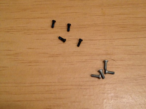

    • Grab your T5 Torx screwdriver, and remove all 8 screws
    • Be careful when taking out screws. The silver ones go in the corners, black ones in the middle

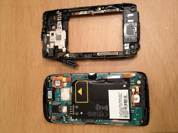

    • With the 8 screws removed, you can gently pry the back cover off. Be gentle, as it is still connected by a ribbon cable
    • Gently pry ribbon cable off, and then you will have the back cover fully removed

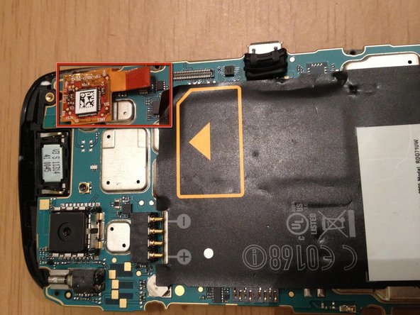

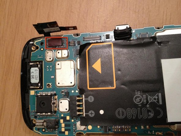

    • The next step is to remove the board.
    • There are 3 ribbon cables connected to it
    • Disconnect the first ribbon cable
    • When you remove the second ribbon cable it will reveal the third ribbon cable

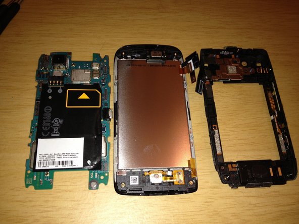

    • With the 3 ribbon cables disconnected you can gently pry the board up and away from phone
    • With the board removed, you can then simply lift out the LCD display
  7. BlackBerry Torch 9860 Handset Disassembly: crwdns2935265:07crwdnd2935265:01crwdnd2935265:01crwdne2935265:0
    • Once the LCD is removed, the handset disassembled.
