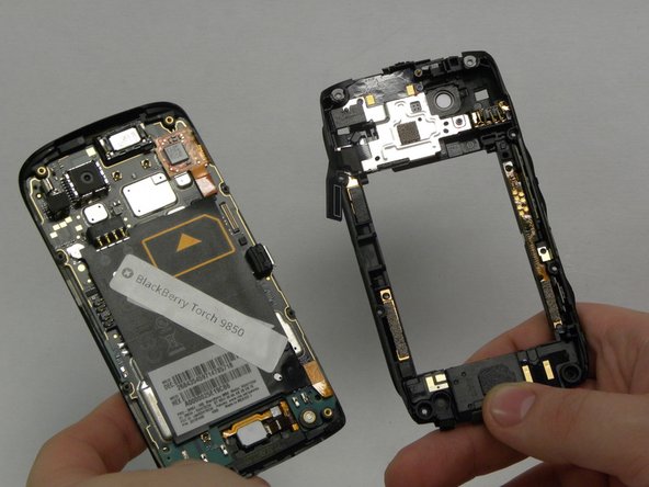

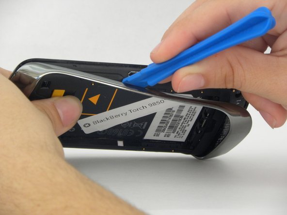

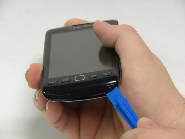

    • Remove the plastic bezle.
    • To remove the plastic bezle on the back of the phone, use a plastic prying tool to gently pry it off.
    • Begin in the center on the bottom of the phone, and slowly work your way around to each side.
    • Once the bezle is loosened on both sides, you can gently pull it off with your hands.
  4. BlackBerry Torch 9850 Sim card reader Replacement: crwdns2935265:04crwdnd2935265:01crwdnd2935265:03crwdne2935265:0 BlackBerry Torch 9850 Sim card reader Replacement: crwdns2935265:04crwdnd2935265:02crwdnd2935265:03crwdne2935265:0 BlackBerry Torch 9850 Sim card reader Replacement: crwdns2935265:04crwdnd2935265:03crwdnd2935265:03crwdne2935265:0

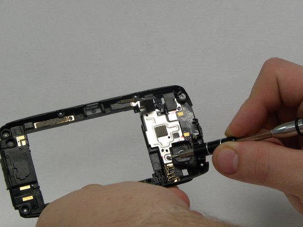

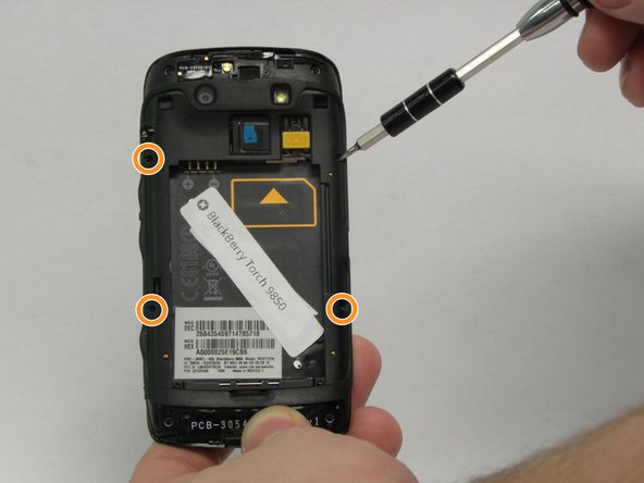

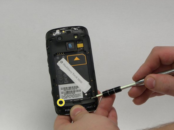

    • Remove the screws.
    • You will need to remove the ten small screws that hold the back of the phone together.
    • Start by using a T5 phillips screw driver to remove the four 4.5 mm screws on the outside corners of the phone.
    • Next, use a T4 phillips screw driver to remove the four 4mm screws on the sides of the device.
    • Lastly, use the T4 phillips screw driver again to remove the last of the screws, which should be two 2mm screws on the bottom.
  5. BlackBerry Torch 9850 Sim card reader Replacement: crwdns2935265:05crwdnd2935265:01crwdnd2935265:02crwdne2935265:0 BlackBerry Torch 9850 Sim card reader Replacement: crwdns2935265:05crwdnd2935265:02crwdnd2935265:02crwdne2935265:0

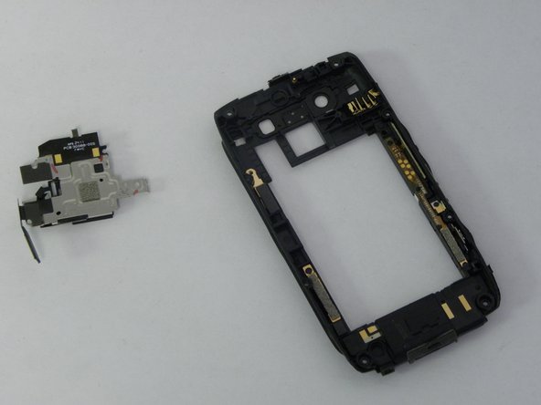

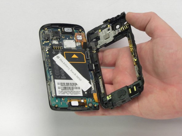

    • Remove the back piece.
    • Once you have all the screws removed, gently remove the back piece of the phone with your hands.
    • Do not pull the back of the phone all the way off, because there are cable ribbons that will break if you do.

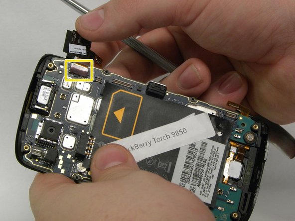

    • Disconnect the main cable ribbon.
    • There will be a black cable ribbon on the upper right side of the phone.
    • Using the metal pry tool, gently pry this cable ribbon open to separate the front and back pieces of the phone.

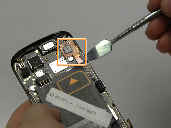

    • Disconnect the remaining cable ribbons.
    • There are two copper cable ribbons.
    • Using a metal pry tool, carefully disconnect the first copper cable ribbon on the bottom right side of the phone.
    • Likewise, disconnect the square copper cable ribbon at the top right of the phone.
    • Once you disconnect the first square cable ribbon, a second will be exposed and you can disconnect that one the same way.

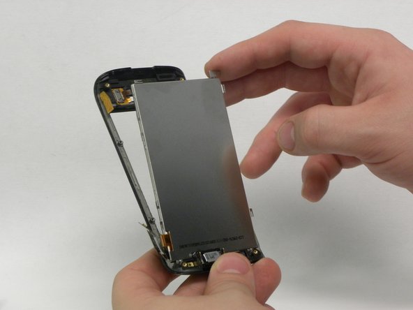

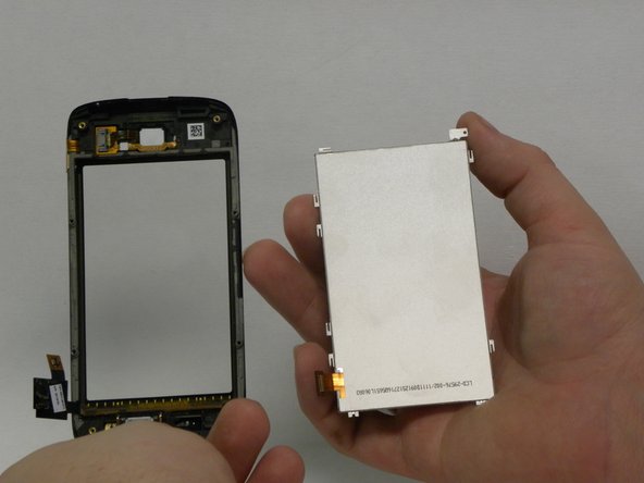

    • Remove the LCD screen.
    • Once you have completed all of the previous steps, you can remove the display.
    • Gently pry on the little tab at the top of the screen to remove it.

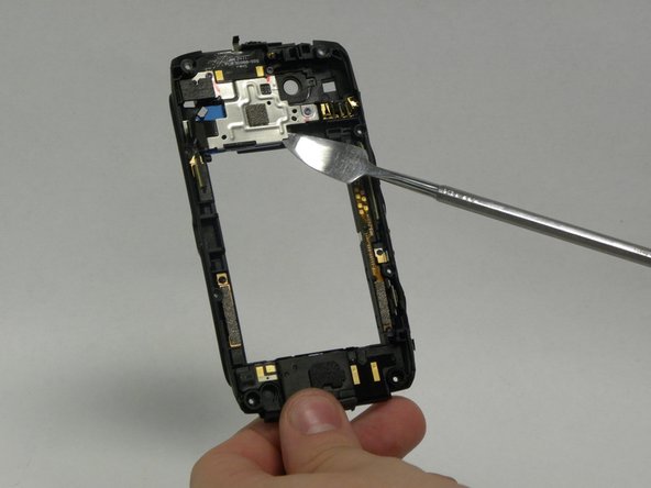

    • Remove the sim card reader.
    • Use the metal pry tool to gently remove the sim card reader.
