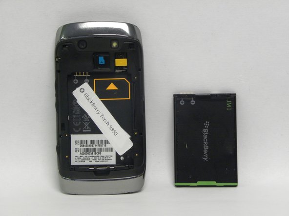

  3. BlackBerry Torch 9850 Battery Replacement: crwdns2935265:03crwdnd2935265:01crwdnd2935265:03crwdne2935265:0 BlackBerry Torch 9850 Battery Replacement: crwdns2935265:03crwdnd2935265:02crwdnd2935265:03crwdne2935265:0 BlackBerry Torch 9850 Battery Replacement: crwdns2935265:03crwdnd2935265:03crwdnd2935265:03crwdne2935265:0
    • Remove the battery.
    • Once the plastic covering is removed, you can remove the battery.
    • Use your fingers or a plastic spudger to pop the bottom of the battery out of its place by pushing and lifting.
    • Once the bottom of the battery has ejected, you can easily remove the whole battery from the phone with your hands.

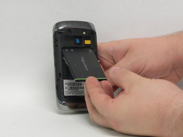

    • Inserting a new battery.
    • Align the plus and minus signs at the top of the battery compartment with the plus and minus signs at the top of the battery.
    • Push battery into place.
    • Replace the plastic cover by snapping into place.
