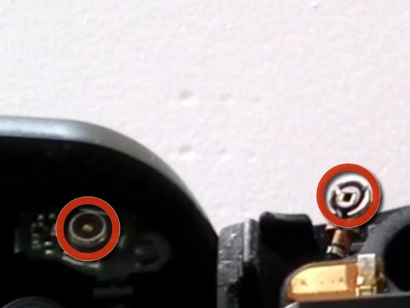

    • Now use a safe pry tool, and go along the edges of the phone to release the clips to open the housing. There are a total of 6 clips, 3 on each side.
    • There is a small cap connection that connects the antenna to the logic board as pictured.

    • Once you have worked you way all the way around the device with the safe pry tool you can now separate the two pieces of the housing.
    • *Be sure to remove the antenna cable in the top portion of the housing. You will need to reattach this when you repair the phone*

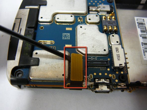

    • Now remove the logic board & LCD assembly from the rear housing. Be gentle, and do not use excessive force.
  10. BlackBerry Storm LCD/Digitizer Replacement: crwdns2935265:010crwdnd2935265:01crwdnd2935265:02crwdne2935265:0 BlackBerry Storm LCD/Digitizer Replacement: crwdns2935265:010crwdnd2935265:02crwdnd2935265:02crwdne2935265:0
    • Flip the logicboard around so that it is sitting on top of the screen, now remove the two ribbon cables for the LCD & Digitizer.
